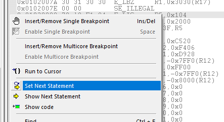

I am using SPC58EC disp board. I can upload code and see led is linking when I reset the board. But I can not debug it, my code’s start location is 0x01020000 but it is going somewhere else. I asked if I can set debug start location to PLS and they suggested me to ask to ST also they said use Hardware Start Mode but I couldnt find anything like that in software. How can I solve this problem? Thank you.

If I look the map file and find reset handler address I can go to that address and click "Set Next Statement" it starts correctly and working well. But for this I should check map file and go to that address with mouse, it cant find address and it takes time. For now it is working but it is better for me to know how to set start address.
