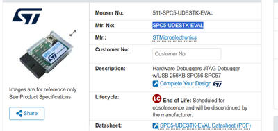

Thanks, Erwan for your immediate response.
The SPC5-UDESTK is obsolete. Please recommend a suitable debugger with an appropriate part number. we are using spc560p
