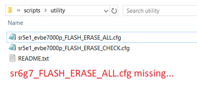

I'm trying to download SR6G7 elf code into internal Flash. So far this MCU seems to be not directly supported from the StellarStudio (?).
Is there a way of programming my board using StellarLink from the command line? I found a working solution for other chip (like SR5E1):
C:\StellarStudio-2.0\openocd\bin\openocd.exe -d0 -s C:\StellarStudio-2.0\openocd\scripts -f board\sr5e1_evbe7000p.cfg -c "program blinkled_portE13.elf reset exit"
However, there are missing SR6G7 configuration files in the latest StellarStudio_rev4.1 and StellarLink releases. The one defining target board I could prepare myself, yet the other describing SR6G7 chip and FLASH_ERASE algorithms are not available.
Can someone worked already with that chip and could share the proper config files (chip and algo)?
