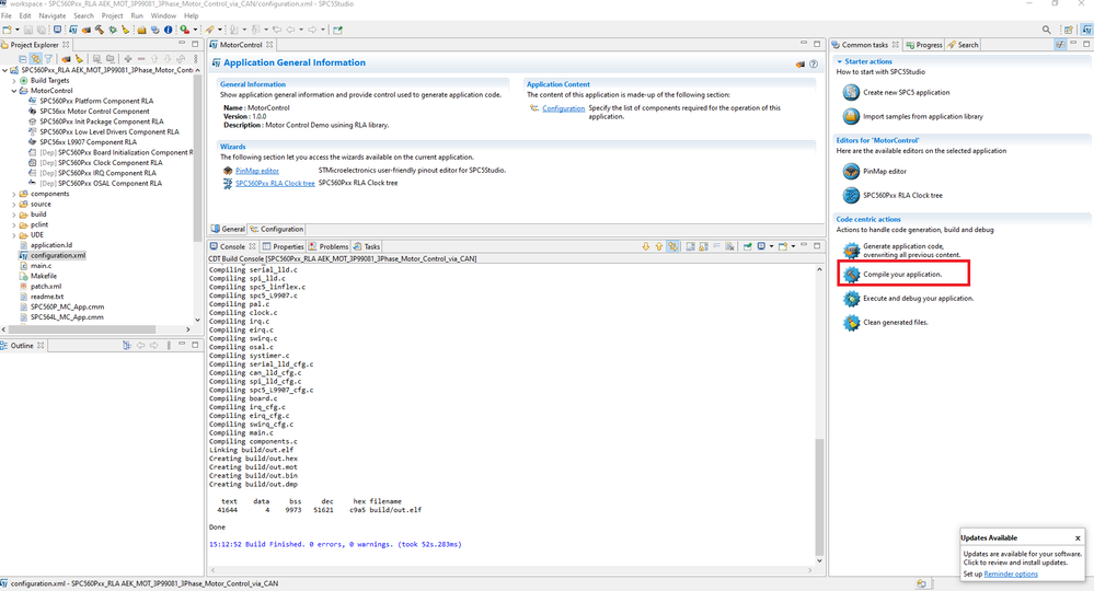

Hello Rassom ,
I think that you have broken you environment variable or your settings.
Could you try the button Compile your application on the right not the CDT Button ?
(cf screenshot)
make should be installed in the gnutools feature.
Best Regards

2021-11-12 10:50 PM
Thank you, that works.
