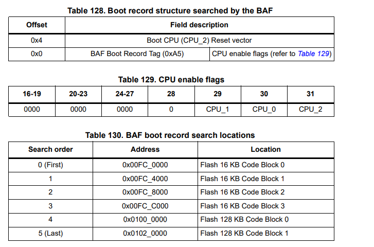

Based on the SPC58 H Line Reference Manual, I checked the Boot record structure searched by the BAF on SPC58 flash and they all was correct as I've known:
  • Addr 0x00FC_0000: value=0x00A50000
  • Addr 0x00FC_0004: value=0x00FC8000 (It is start address of Boot CPU (Core2) Reset vector table)
0693W00000HrBs3QAF.pngI think I missing any setting for SPC58 flash but I cannot find more information currently.

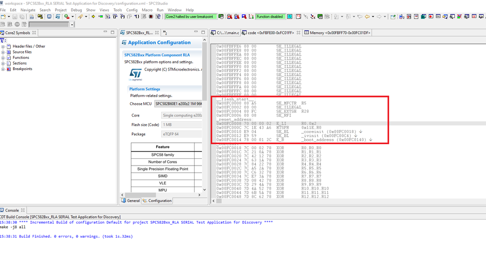

the strategy to detect a valid boot header is detailed in the figure 47.
Your address seems to be correct :
Please enter to debug session with your debugger
your reset address should be 0xFC0008
0693W00000HrGUuQAN.png Best Regards
Erwan
