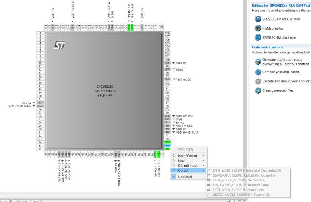

in order to change the PINs setting enabled by means of Pinmap wizard you need to save the change and close the Pinmap view. After that, the main application tab must be also saved in order the changes comes saved into the project.
So that:
Save everything and regenerate the code to have in place the new settings.
Hoping to have meet your request please let me know.
Regards,
Angelo

@Angelo Castello Your solution worked like a charm but how is one supposed to know this? Is there some documentation I missed?
