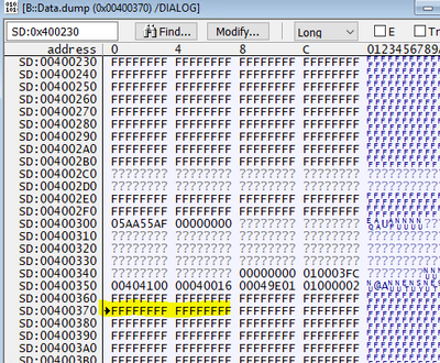

I'm using Lauterbach to program DCF record to UTEST block. After I run my cmm script, there is no error but the DCF record is not program to the UTEST.

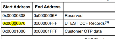

The DCF record start address is 0x00400370, I have dumped memory and see that there is no DCF record at this address.

"Data.set 0x00400370 %QUAD 0x0000003100400040 0x0000003100400040 ;"
You can check my attached cmm script.
