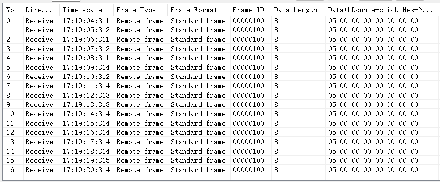

I'm using SPC58 DISP Board for RTR request data frame from a battery pack. I have set the RTR value as 1, but didn't receive any reponse data frame from the battery. I have tested with CAN analyser, reponse data frame is coming(working fine). When I looked into the code, I didn't see any RTR register loading with the value. So, if anyone worked on RTR frame request. Kindly guide me.

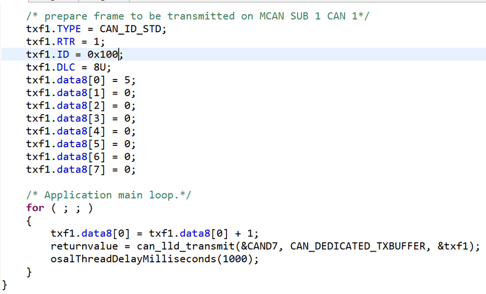

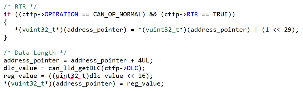

I got RTR frame by adding some code which is included below. But the problem is If I tried change the data, its doesn't change in the CANbus message.
The code I included before the "Data Length" section in the "can_lld_writeTxBuffer" function.Screenshot 2024-07-18 172639.png
The code in the main function. Here I have increamented the data8[0] by 1 every loop. But it doesn't reflect in the CANbus message.Screenshot 2024-07-18 172055.png
