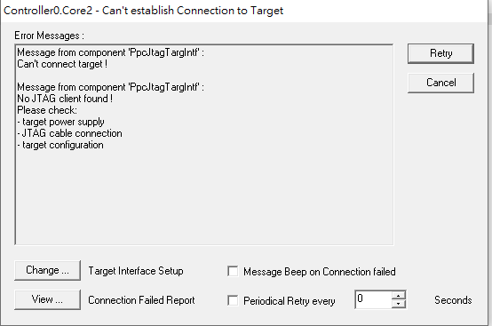

2024-02-26 7:37 PM
Hi FP,
Thank you very much for your response. However, I have been using UDE STK for the programming operation before. In this case, can I still use the method you mentioned to execute a script for the clear operation?
Additionally, I am using the FTDI on the development board. If I don't connect it via USB, it seems that there won't be a connection pipeline with the PC.
Thanks.
device name on my device manager
connect fail on UDE STK
Ethan

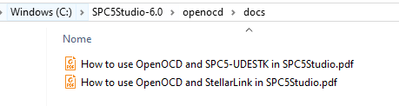

Done that and plugged the cable, you should check that the device is showing in Windows (I don't know if in your previous image if you have 2 boards attached or there are 2 devices loaded).
The StellarLink is basically an FTDI chip which is operated through the OpenOCD scripts and configuration files.
OpenCD is not installed by default in SPC5Studio IDE, but this can be achieved going on Help/Install new software: repository = https://download.eclipse.org/embed-cdt/updates/neon
package: Embedded C/C++ OpenOCD Debugging (incubation)
After the installation you shoud have these pdfs inside the SPC5Studio folder.
I think but not remember exactly that you should already have the StellarLink folder inside C:, as it is installed with the SPC5Studio (if you use it).
