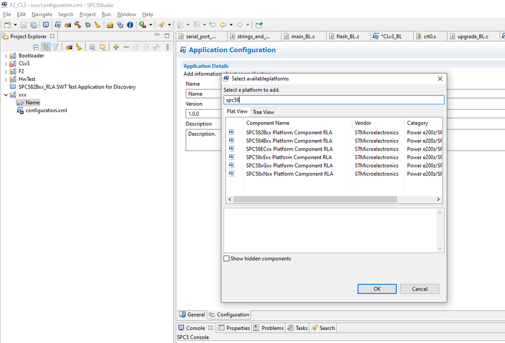

When I create new project and press green "+" icon, I can see only regular RLA platform components:

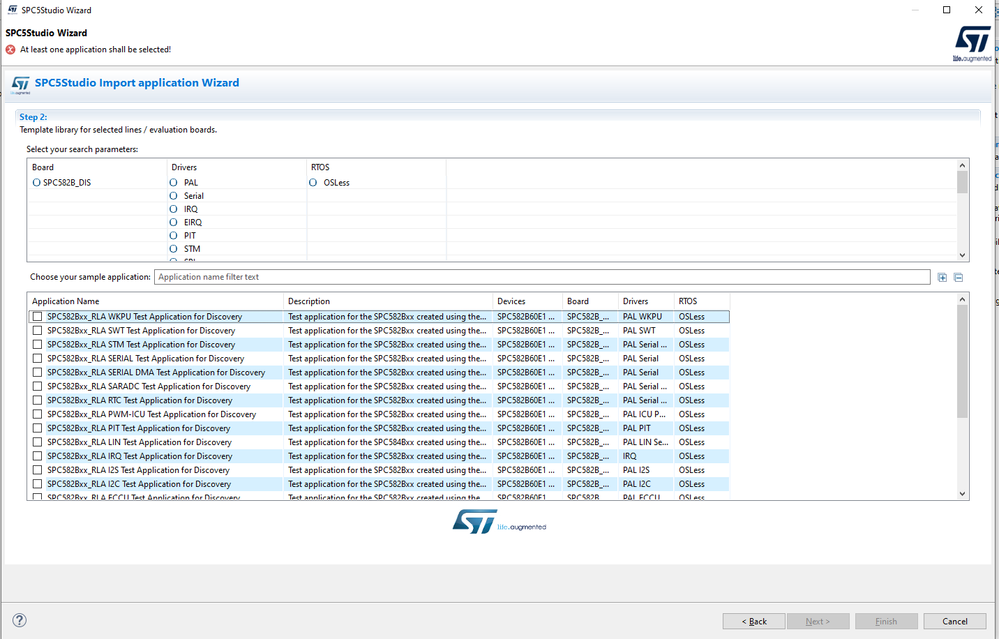

When I try to get through "Common tasks" --> "Import samples from application library", there is also nothing related to "boot loader" in following view:
Am I missing something? I have SPC5Studio 6.0, which seems to be the latest.
