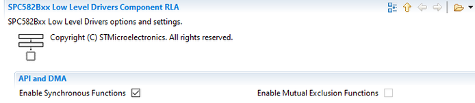

SPI APIs are configured synchronous:

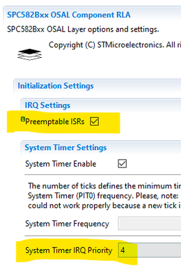

I already activated the preemptable ISR option in the configuration:
Since I don't know if the priority level is ascending or not, I tried both priority situations, that is:
System timer (PIT0 CH0) priority: 4                    DSPI0 priority: 10
System timer (PIT0 CH0) priority: 10                  DSPI0 priority:4
