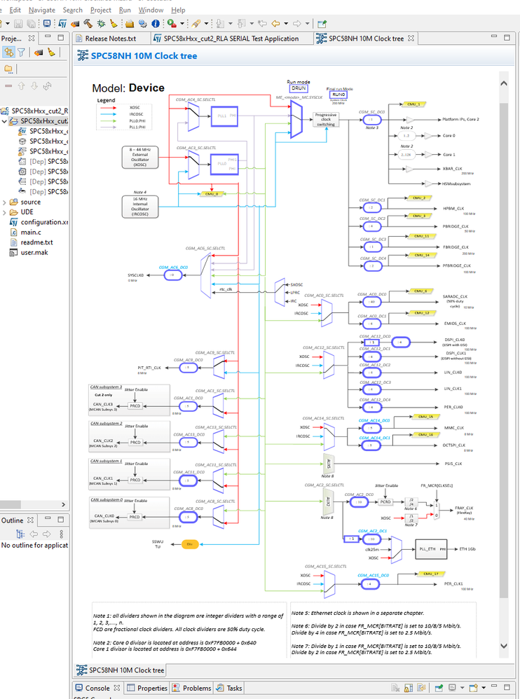

On the different IPs, you can check the clocktree
