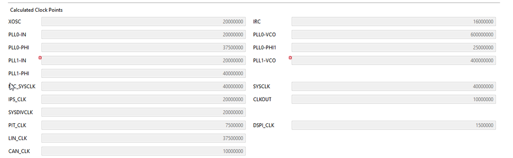

I am working on SPC574S64 Controller, A20MHz Crystal is used in our board
I tried to configure it in the SPC5Studio
I tried using one of the example code for the configuration where a 40MHz is used in the configuration and I tried to change to 20MHz, but could not succeed
I tried modifying the dependent registers, but still nothing worked out.
It is showing an error as below
_legacyfs_online_stmicro_images_0693W00000bi2xqQAA.pngI could see the ranges are as below for them
I tried changing the PLL0 Settings but nothing gave me the positive result
Could you kindly suggest settings for a 20MHz crystal

ODOUV.1
It seems the clock MIN values are too high.
Meanwhile we are cross-checking the MIN/MAX values, here is a temporary workarround to allow you to configure with ext-clock at 20 MHz :
open plugin.xml in directory :
C:\SPC5Studio-6.0\eclipse\plugins\com.st.spc5.components.clock.spc574sxx_rla_1.18.0.20221220104643(you could have a different version)
modify min values for:
brief="PLL1-IN clock point."
and
brief="PLL1-VCO clock point."
and save plugin.xml
then restart SPC5Studio in terminal with clean option:
$ ./SPC5Studio.exe -clean
then after code generation, you will have to patch in:
components/spc574sxx_clock_component_rla/lib/include/clock.h
-#define SPC5_PLL1VCO_MIN          600000000U
+#define SPC5_PLL1VCO_MIN          20000000U
Best Regards.

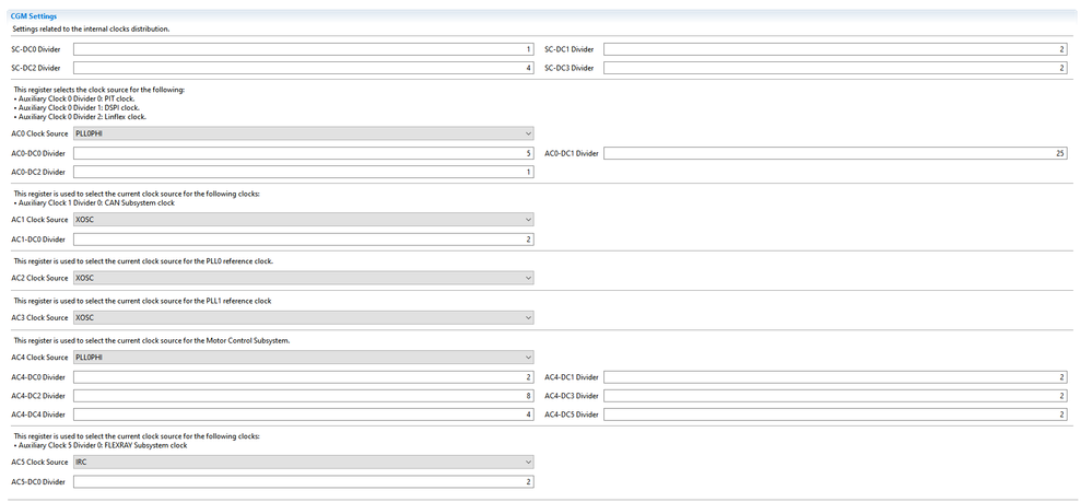

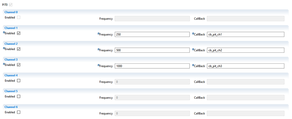

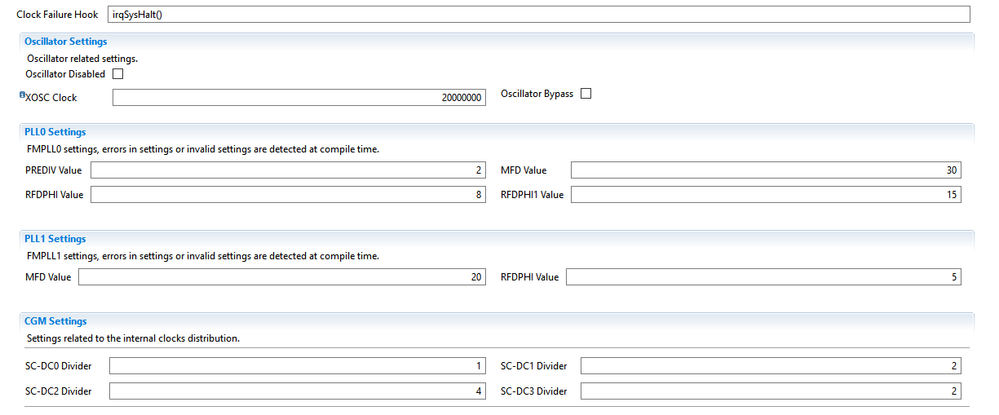

Thank you very much for your response. I tried the suggestions and was able to generate the code and build it. I am using the PIT Timer application example from SPC5 Studio and Here is the Crystal configuration Settings and Timer settings below.
_legacyfs_online_stmicro_images_0693W00000bi9f4QAA.pngand
PIT Settings

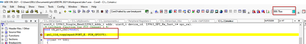

The Issue I observed is that the Timer 1,2,3 are configured at 250Hz, 500Hz and 1000Hz, but when I flashed in the debugger and observed the Timer 1,2,3 response is 1ms, 500us and 250us correspondingly. Is there any thing need to be modified in Crystal settings? Kindly Suggest

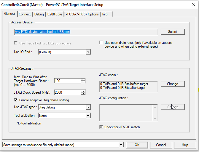

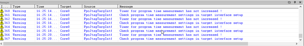

Also I am seeing this warning in the debugger window UTESTK
_legacyfs_online_stmicro_images_0693W00000bi9gbQAA.pngThis is the Target Interface setting.
Kindly suggest if there is any change need to be done in the debugger
I have no clue on Studio Tool side about your new issues.
In order to maximize your chance to have support, I would suggest you to enter one question for each problems (keeping this one for Studio minimum clock issue).
