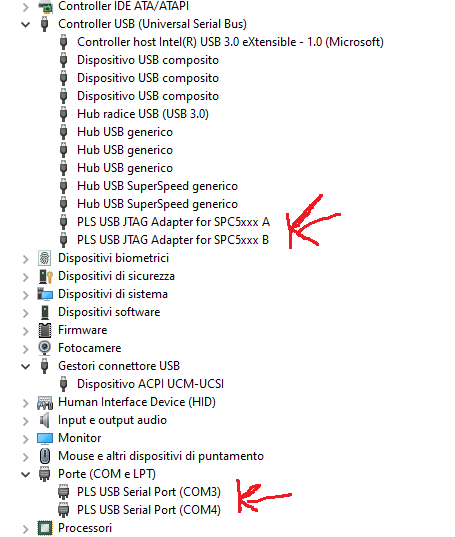

The drivers for FTDI and PLS USB JTAG adapter are installed and configured in device manager settings:

Greetings Every1,
I answer to myself: by disabling in WIndows Device Manager one of the two interfaces, the debugger now works OK.
Right-click, select disable.... (you can re-eanble at anytime)
