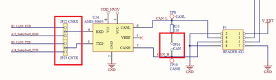

Hello @Louie33 ,
I'm not expert of Automotive MCUs, but:
1- check if JP10 is fitted to enable the 120 ohm terminating resistor.
2- Check also the position of JP22 and JP23 and if they are in the correct position.
Compare them to what you have on the old board.

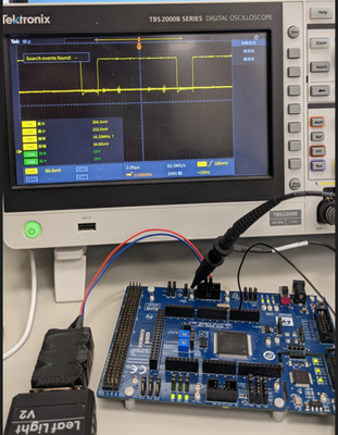

Today, I tried using an oscilloscope to measure the CANH waveform.
Below are the oscilloscope waveforms from the SPC560P-DISP I already had:
The waveform generate normally.

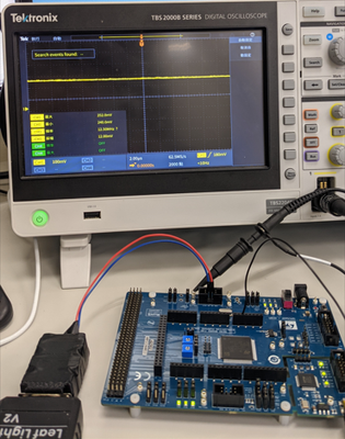

Next, I test the newly purchased SPC560P-DISP:
Then no waveform was generated on CANH.

Thank you. I previously not consider this is a hardware-related issue. After checking JP22 and JP23, I discovered that their positions were both set to the pins for CAN channel 1, which caused data transmission on CAN channel 0 to fail.
