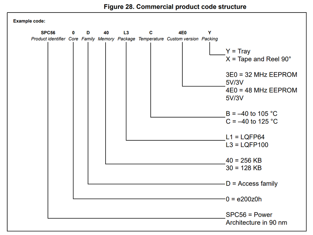

SPC560D40L1B3E0X, SPC560D40L1B4E0X and SPC560D40L1C4E0X. Why is there 3 Different onces?

i am looking to buy a couple of those for a project i just startet with.
Is there any differents that is worth to mention between those 3 types?
Just looking forward to which one i should buy.

Giuseppe DI-GIORE
0693W000005D2igQAC.pngHello,
please have a look at the above picture which describes the product code structure.
This picture is available at page 75 of the SPC560D datasheet, here the link to the mentioned datasheet:
ttps://www.st.com/resource/en/datasheet/spc560d30l3.pdf
Regards,
Giuseppe
