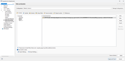

I have installed SPC5 Studio version 6.0 on my Windows 10 PC and compiled sample code.
When compiling the project , i got below warning/issue "Type 'uint32_t' could not be resolved"
Q1: Can you give the solution for this?
2024-08-22 6:48 AM
Thank you so much for the answer. It really helped.
For others to refer to his solution, you can refer to the below screenshot. |
I added only one directory and it resolved:
C:/SPC5Studio-6.0/eclipse/plugins/com.st.tools.spc5.tools.gnu.gcc.ppcvle.win32_4.9.4.20200908161514/toolchain/lib/gcc/powerpc-eabivle/4.9.4/include
