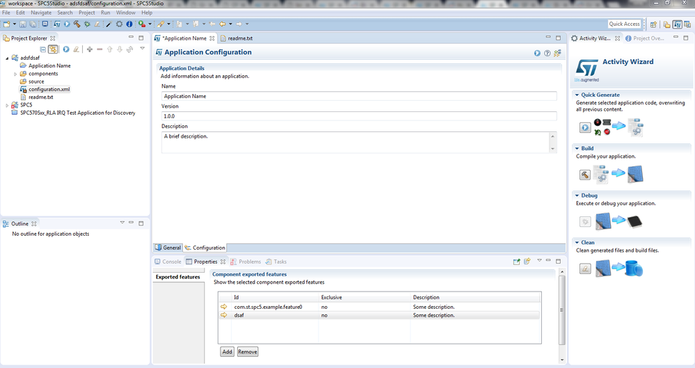

2017-02-28 9:12 AM
Hello Erwan, can you show me an example? Not sure if I am doing it right. I can add components, but its not really doing much. If I click on configuration, it brings the ''Application Configuration'' page. See picture below.

2017-03-02 9:06 AM
I am creating the project using the 'SPC5 C/C++ Application' wizard, but as I mentioned before, I don't see any options for selecting the micro, clock configurations, adding any drivers, etc.
I am able to load the example applications that are meant to be run on evaluation board from the 'SPC5Studio Application Wizard', but it does not provide me with options for changing or adding many of the components.
I am following the same steps as that shown in section 2.1 of UM1602 SPC5 Studio Users Guide for creating an SPC5 application. I am not able to perform the steps mentioned in section 2.2 ( assembling the application) since I don't see a 'Structure' tab in the configuration editor window.
2017-03-03 2:06 AM
Hello ,
There is a help section in SPC5Studio for SPC5Studio Wizard and screenshot associated
you can go in 'SPC5Studio Wizard' not 'SPC5 C/C++ Application'
we have a lot of xamples for differents boards
Best regards
