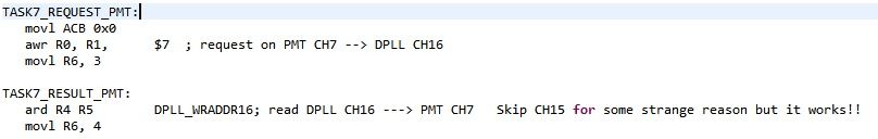

Our SPC572L application are using both MCS1 & MCS2 connected to DPLL and ATOM it works well on all 16 channels except the last one: channel 16 "SPC5_GTM_DPLL_ACTION_ID_15" if we change to ch17 "SPC5_GTM_DPLL_ACTION_ID_16" it runns fine but we need to use all 24 channels soon with the SPC572K device.
Is there a known workaround?
/Lars
