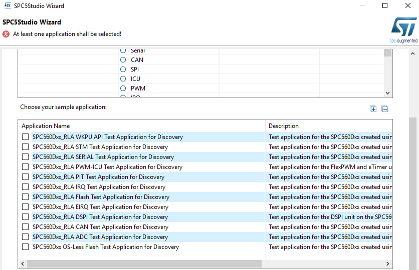

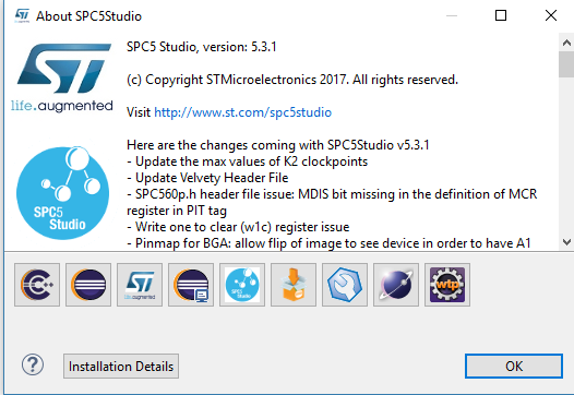

2017-05-30 3:54 PM
Hello Erwan,
thank you for your reply.
Perhaps I'm missing something...
I have SPC5Studio v5.3.1 (just updated)
I looked among the exaples avilable for SPC56DXX but I couldn't find the one you mentioned (the pciture below shows what I get)
Anyway, supposing my function is called myFun, think I need to have something like:
__attribute__ ((section (''.ram_code''))) void myFun( void )

2017-05-31 1:38 AM
Hello Alessandro ,
Could you install HAL components from the Official Update Site ?
Help ==> Install new Software
Best regards
Erwan
