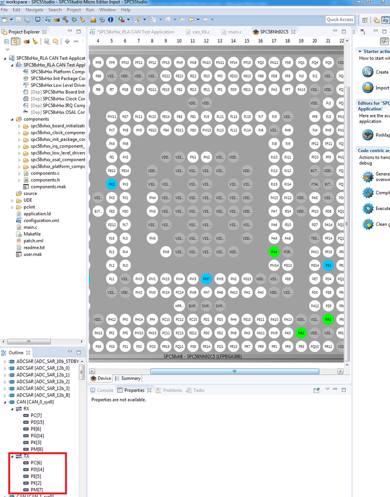

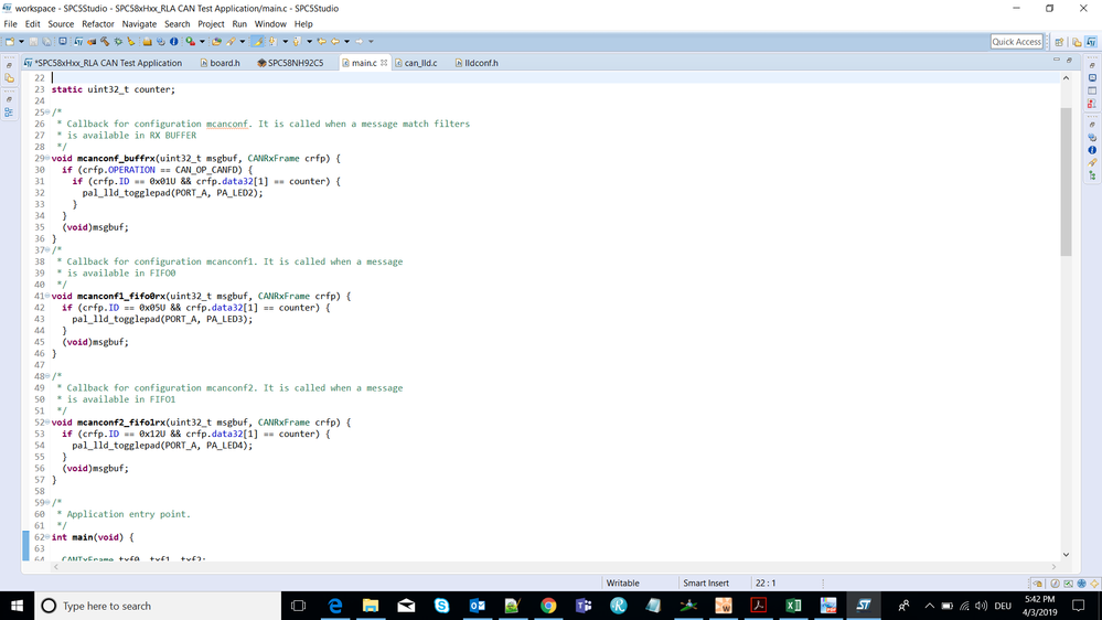

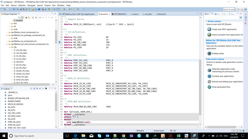

I used the example application of CAN from SPC5 stdio. As mentioned in the application programs LED's are blinking but i was not able to see the msg in Vector CAN case or in the logic analyser. I need to do any extra modification in any file so that i can view the masg sending from the application.

Have you tried to update the Pinmap Wizard ?
