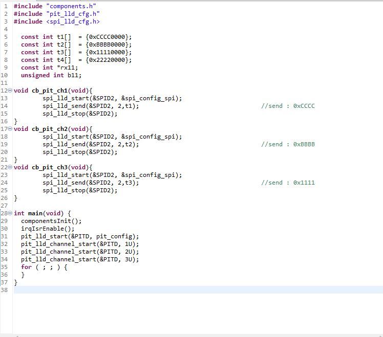

I want to send some SPI command periodically in SPC560p40 Microcontroller, so I am trying to generate a periodic interrupt request using PIT. I take “SPC560Pxx_RLA PIT Test Application for Discovery�? as example and write my code as bellow:

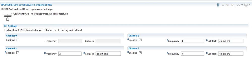

0693W00000JOFsHQAX.jpgAlso you can see my PIT settings below:
 But I observed that the PIT with lowest timer is triggered only once and is not triggered any more. Also other PIT don’t work.
0693W00000JOFrxQAH.jpgCan you help me to solve this problem?

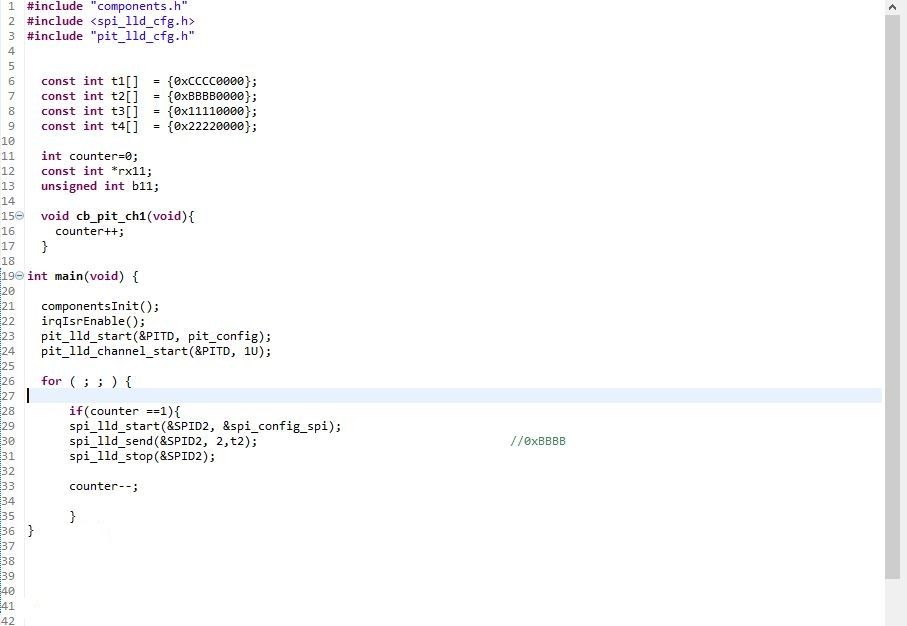

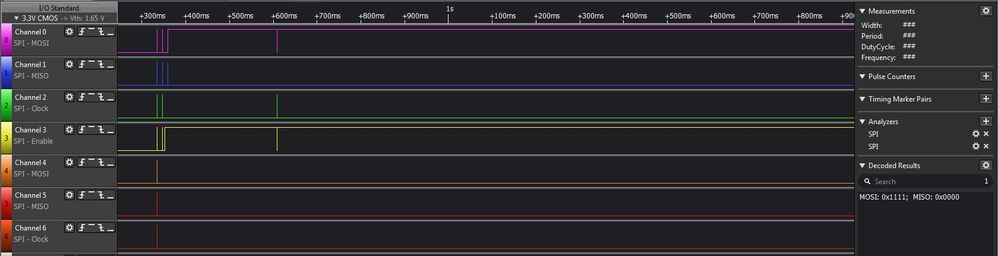

0693W00000JONDqQAP.jpgbut I observed that the PIT don’t work and don't send any SPI command.
with regards
Bahareh

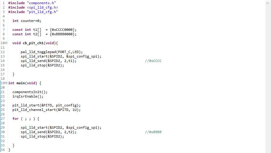

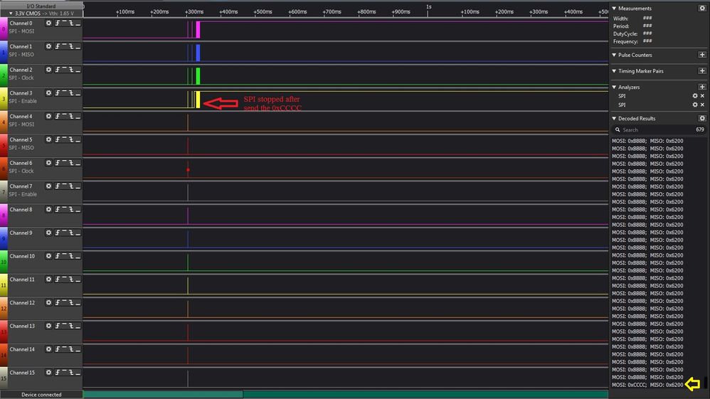

I send the SPI code(for example 0xBBBB) in main loop and toggle a LED in callback function, when I use them separately, both of them works good.
But when I send the SPI command(for example 0xCCCC) in PIT callback it just send 1 code at the required time and then the MCU stop!!!
I check two cases:
1- use SPI code directly in callback function
2- use a counter in call back function and use the counter as condition for SPI command.
but in both cases, after 1 callback function, the LED toggle and SPI command stop working.
0693W00000JOp3yQAD.jpg0693W00000JOp4DQAT.jpgI also try use 1-4 Hz frequency, there is no change in result!
I think something is wrong when I use SPI in PIT callback function!
Giuseppe DI-GIORE
spi_lld_send() needs interrupts to complete, then if called from an interrupt routine
need to do the following:
  • enable nested interrupts
  • configure SPI interrupts with a priority higher than PIT interrupt
  • in the PIT interrupt callback
    • osalExitCritical();
    • send SPI command
    • osalEnterCritical();
Regards.
