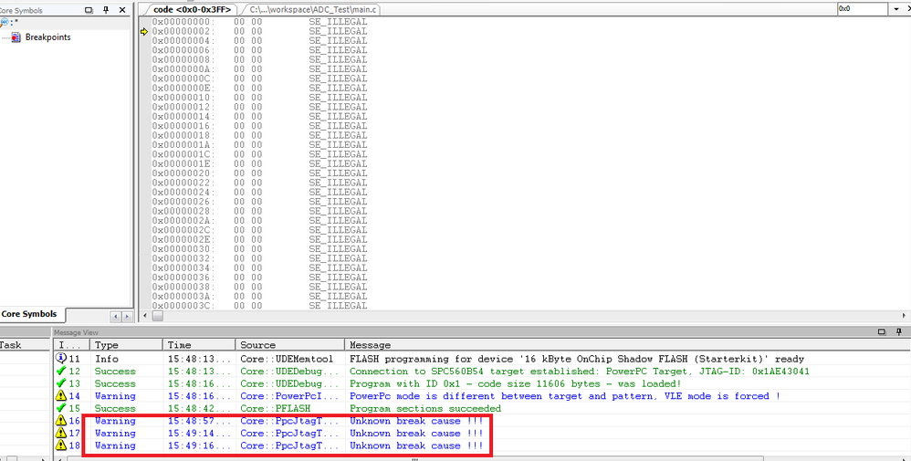

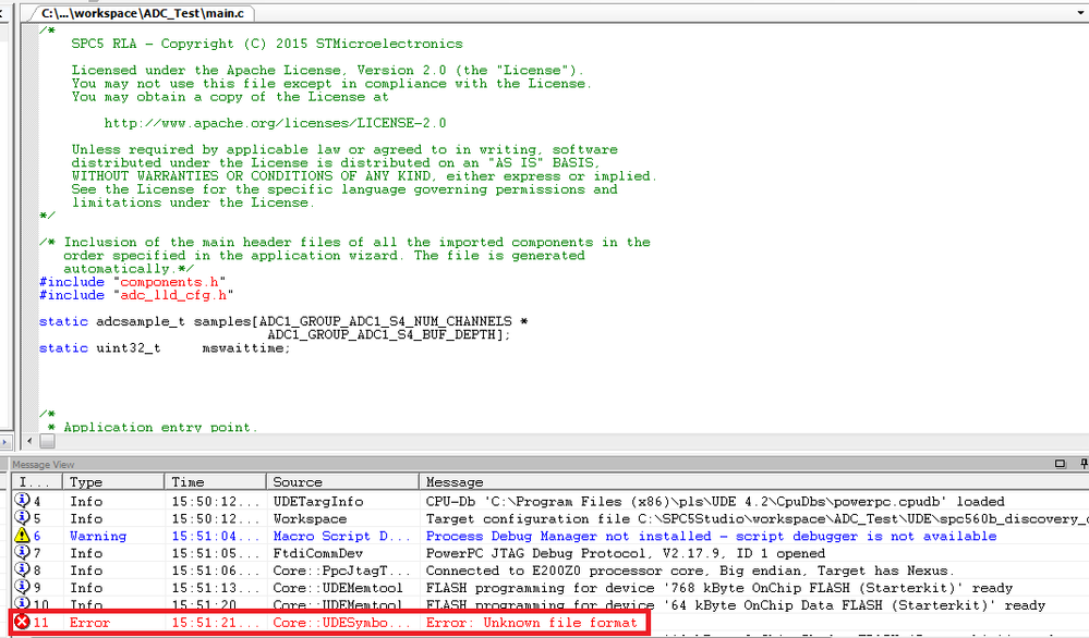

I am using SPC560B54L5 Discovery board(SPC560B-Discovery), SPC5studio version 5.2.3 and UDE Visual Platform 4.2 version.
When I try to load the application the .elf is working fine. If i try to make use of .hex or .bin file (as per my requirement)
I am facing following problems,
When I try to load ''.hex'' file the code gets loaded successfully but while running it is throwing an error as '' Unknown Break cause''. Similarly, when I try to even load ''.bin'' file it prompts with ''Unknown File Format'' error.
Error While loading .hex file:
Error While loading .bin file:
Kindly suggest if I need to do the changes to the settings or preferences in IDE (or) UDE

Dear
R.santhamurthy
,PLS UDE is debugger
You can not debug by a hex file and put some breakpoints
if you want to debug , you have to use the symbol file.
PLS UDE is using Memtool to load in the flash your hex file.
Best Regards
Erwan
