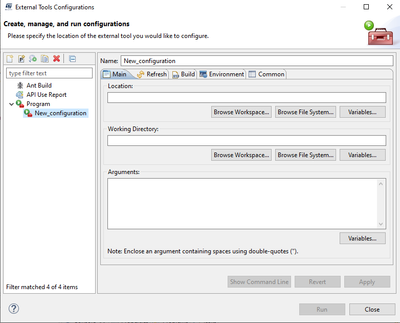

I already have installed UDE-STK-2021, here is the external tool configuration!
do i need to update?
2025-10-20 4:05 AM

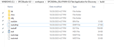

you just need the board connected via USB, the USB driver properly recognizing the PLS ports in Windows and the .elf file found in the project folder after source code compilation is completed.

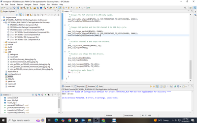

what is the problem here!

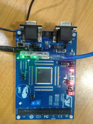

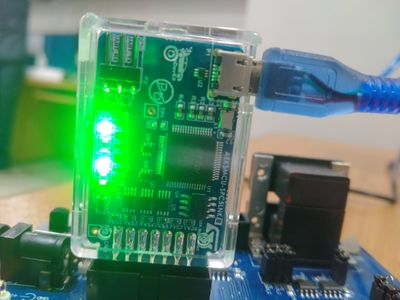

I see nothing wrong on your shared pictures.
Now you should flash your board using PLS UDE. (use the .wsx file, you will find it into your UDE folder)
