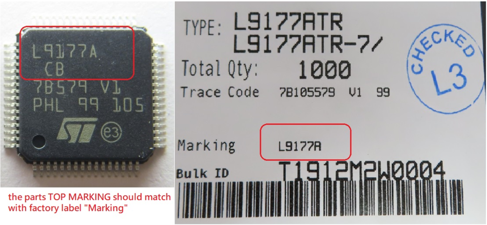

Parts TOP marking cannot match with factory label Marking for MPN#L9177A-TR
Please help to check the attached picture and let us know what does CB notes on the marking of the chip.

The additional marking CB on the component is an internal one, here the relevant device marking is the first row, i.e. L9177A which matches the marking mentioned on the label.
