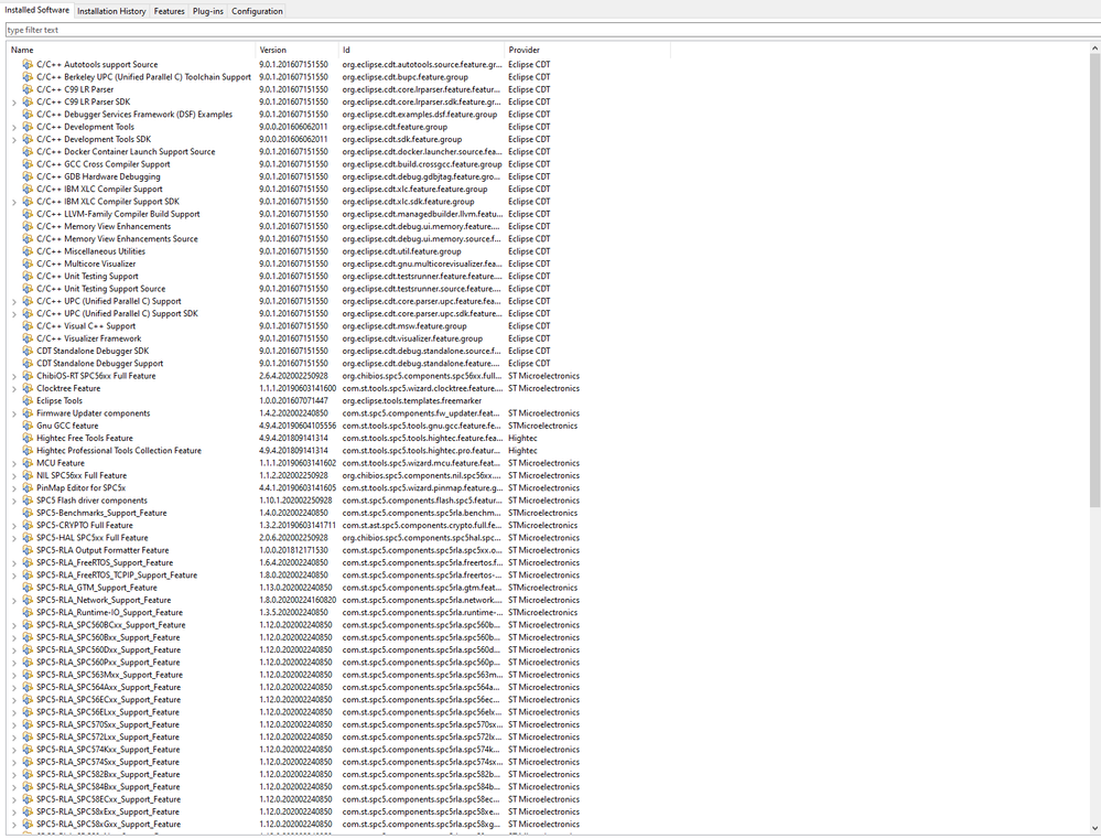

Sure, attached my installation details.
SPC5 STUDIO V5.8.1

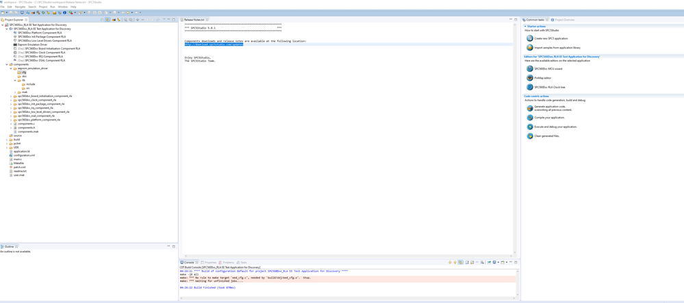

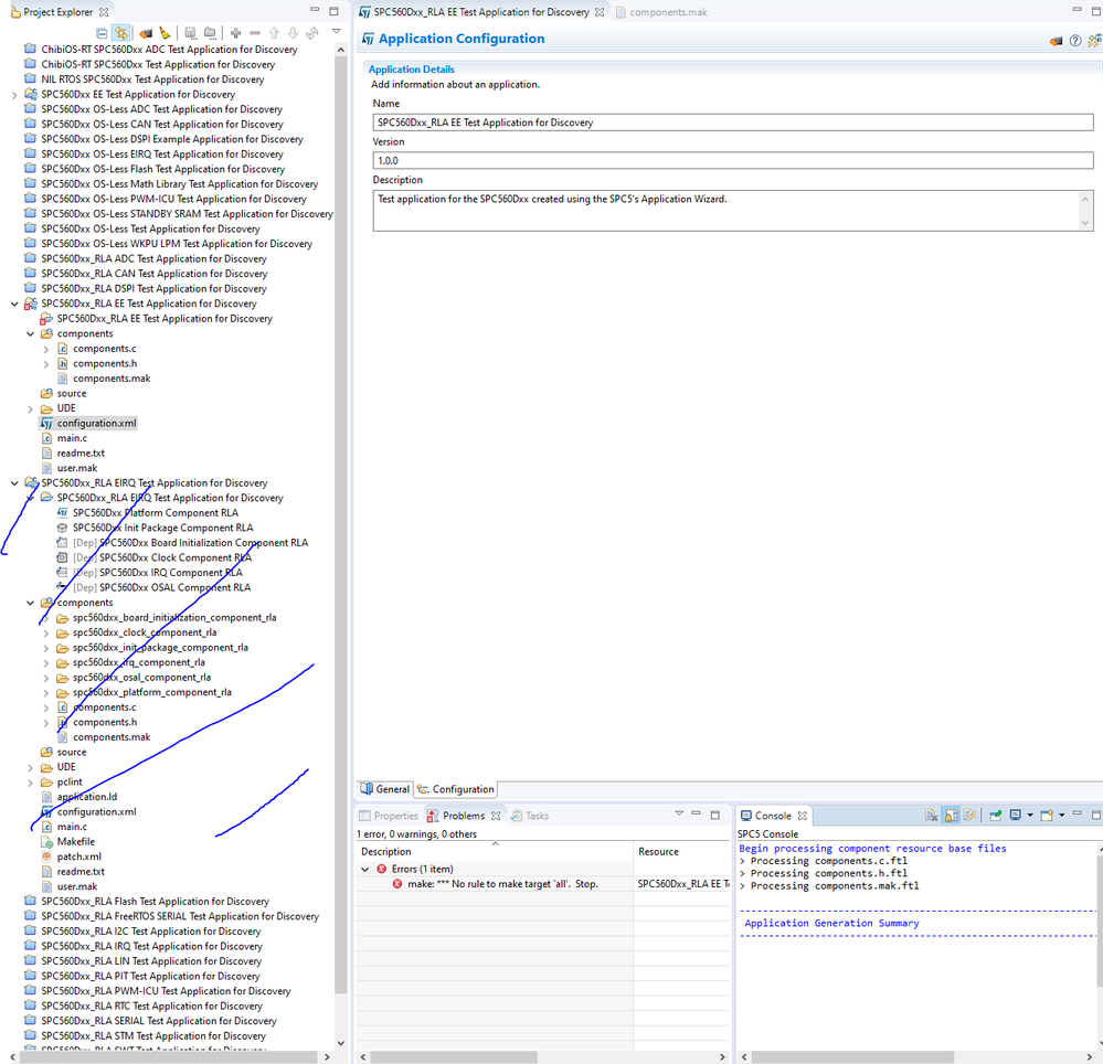

I've also just run into the same issue using one of the OS-Less examples <chibios>. For the can hal example
i feel like something hasnt installed properly
<update: all the chibios examples do not compile after generation>
with the error
11:27:36 **** Build of configuration Default for project ChibiOS-RT SPC560Dxx ADC Test Application for Discovery ****
make -j8 all
make: *** No rule to make target `all'. Stop.
11:27:36 Build Finished (took 100ms)
After compiling each example the ones that do not work after generation are:
SPC560DXX_RLA EE Test application for discovery, doesnt generate the files required
All- OS-Less examples, all have the same error as above

I went ahead and uninstalled the eeprom component and reinstalled it.
this now doesnt that error i initially had BUT now it doesnt even attempt to build up the components.
resulting in a no rule to make target all stop. this is a clean uninstall and reinstall of the component from the eclipse link provided in the 'install new software' section
im at a bit of a loss, i tried adding in the files from thje spc5xxxx eeprom directory that has all the .c.ftl etc files but the compiler doesnt like it.
the javascript file for the eeprom isnt in the folder like the other projects. could you confirm if its the same on your end ?

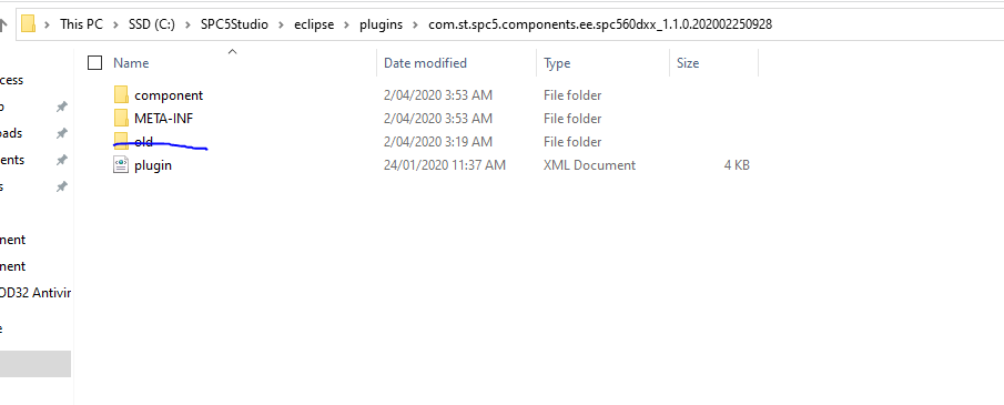

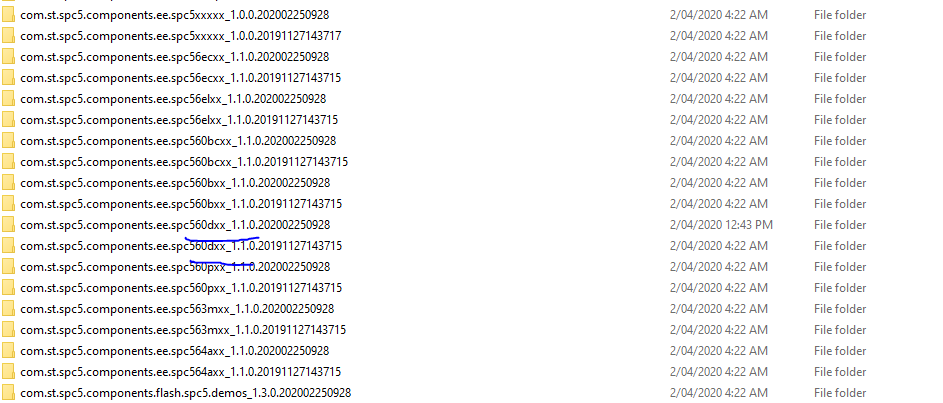

2020-04-02 3:10 AM
Hey Erwan, that installation i had downloaded all the addons through the online installer.

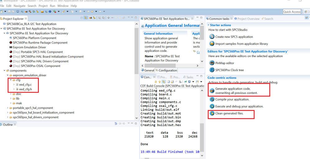

i completely removed spc5studio and reinstalled it. the second time around i didnt download any addons and i had two folders for ee.spc560dxx (attachted image below) one folder had all the files the other had nothing, so i went in and copied the files and now it compiles.

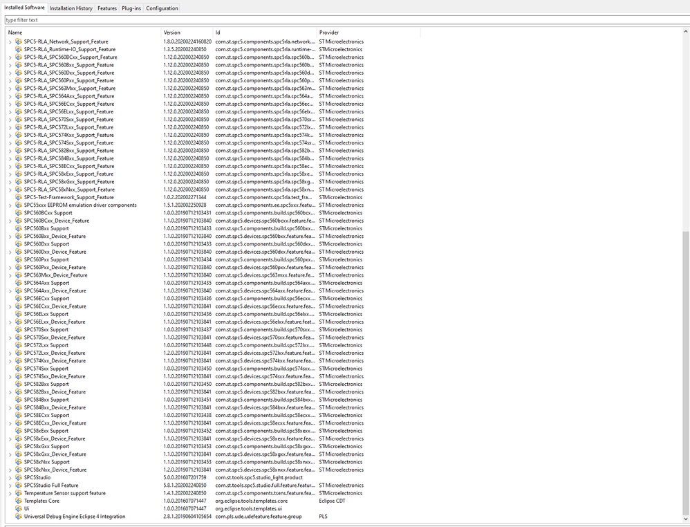

2020-04-02 3:17 AM
attached my installation details, yeah the second time around i made sure to delete the folder after uninstalling.
