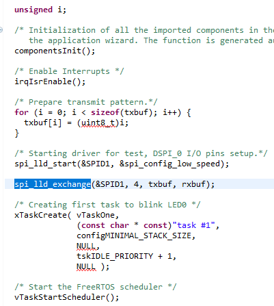

I have a question, Can the function run here? As shown below:
2019-06-24 12:52 AM
Hi Zeke,
you have to be sure that the exchange function is completed before the schedule will run another task. So, probably, it is better to add a delay after the spi_lld_exchange (osalThreadDelayMilliseconds) before the run the schedule.
Best Regards,
Luigi
2019-06-24 4:35 AM
Hi Luigi,
Under your suggestion, the problem is solved.
thanks your very much.
keeping touch each other.
Best Regards,
zeke
