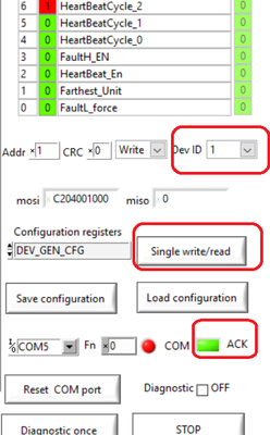

I performed the steps in manual to get it started. I could assign an ID and I could get the green ACK.
As soon as I try to go to the next step (3.2) configuring voltages the ACK turns red. Meaning I can´t send any configs to the device. I tried to read instead of writing, same outcome.
Sometimes I can get the ACK green again if I start diagnostic, sometimes I need to powercycle.

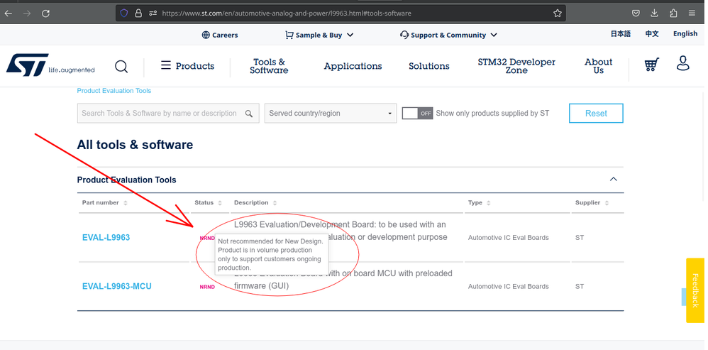

I was surprised that the page about this device seems to be incomplete, (I expected at least the full IC datasheet) and unfortunately I found this, in the software section: "Not recommended for new designs".
https://www.st.com/en/automotive-analog-and-power/l9963.html#tools-software

What?! This was not there a few days ago... but its only the Eval board, not the chip, the chip is still green and it should be for 10 years now. L9963E - Automotive chip for battery management applications with daisy chain up to 31 devices - STMicroelectronics
But still, I purchased it, I payed, i would like to use it...

The evaluation GUI V2.8 should work with L9963E boards with Firmware 1.6 and above.
For L9963 boards with firmware 1.5 , evaluation GUI V1.8 and below should be used.
In any case, after clearing the IDs, please only click Configure ID ONCE.
After that, please select correct Dev ID to read / write to the registers.
Sometimes, when you click "single write / read " , the ACK is RED the 1st time, you can try to click it a few times, and it will be GREEN.
