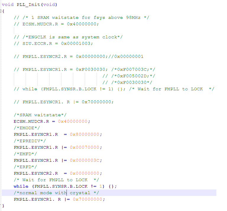

Hello, I configured in enhanced mode for system clock generation, our input clock is 40Mhz external crystal and need to generate 150Mhz system clock. Since hardware is not supported to check CLKOUT pin for system clock, we configured SCK clock for calculating system clock.
NOTE: For above configuration the parameters values EPREDIV, ERFD and EMFD is not satisfying for 150Mhz system clock generation if we substitute in enhanced mode formula. Im confused!!!!!

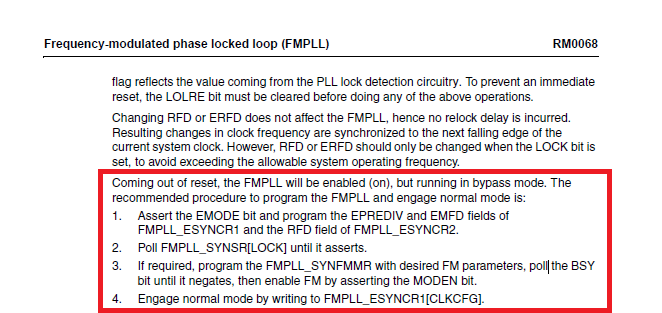

2017-02-01 8:15 AM
you should assert EMODE and program EPREDIV / EMFD by bits
Otherwise the PLL can not locked
Could you respect 1) 2) 3) 4) ?

2017-02-01 8:48 PM
Hello Erwan,
Yes above steps i followed to program the FMPLL and engage normal mode but '3rd' point not configured, frequency modulation not required.
Regards
Mahesh
2017-02-02 12:53 AM
Hello Mahesh ,
Could you send me your clock configuration ?
The first configuration is not correct.
You have asserted your clock by full registers not by bits.
Best regards
Erwan
2017-02-02 5:44 AM
Hello Erwan,
Please check our clock configuration. Mhz
Regards
Mahesh

2017-02-16 12:29 AM
Hello Mahesh ,
I have reproduced your issue.
in putting your clock settings, the PLL can not be locked.
SPC564Axx should support this clock settings.
I am checking with soc functional valid team.
Best regards
