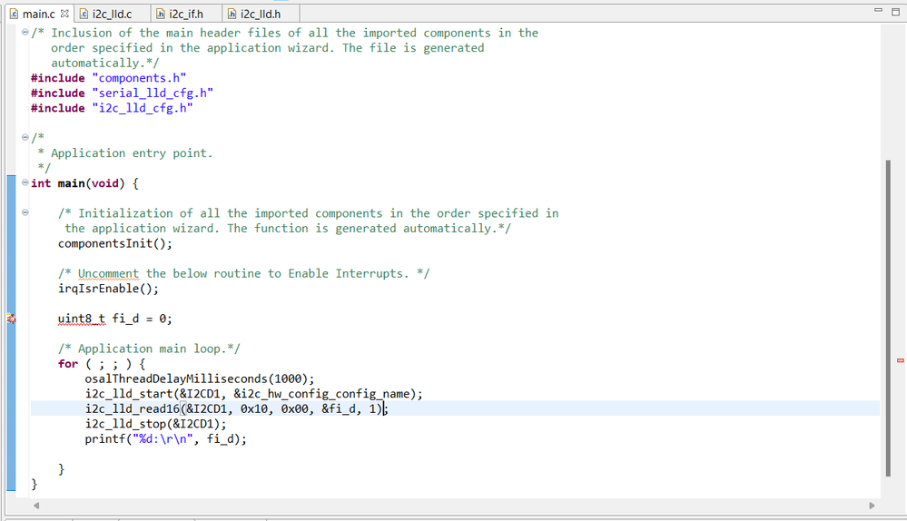

Hello I'm sharan from yali mobilities. Here we are shifting from old spc5 studio to latest version spc5 studio 6.0. For testing I2C, I have used Arduino as a slave device. The programme which I have writen is attached as image. Arduino sends a inter value when an request event is occured. The programme runs in old spc5 studio, but it's not working in spc5 studio 6.0. I have used same configurations, setups and same board.
I have tried I2C write function it works properly for all the devices, which I have tested. If any one knows the solution kindly reply.

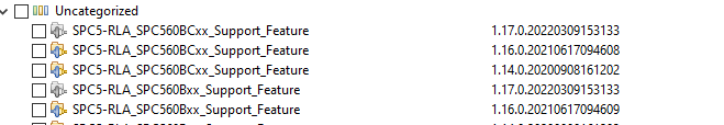

Hello Sharan ,
Could you send me your installation details ?
I need the version of SPC5RLA used for your device
You can revert the drivers installation from 1.17.0 to 1.16.0 , 1.14.0.

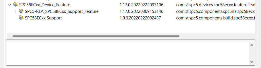

2022-06-01 11:03 PM
Here I've attached the image. I checked for the update and it's upto date. Kindly look into it. Thank you.
