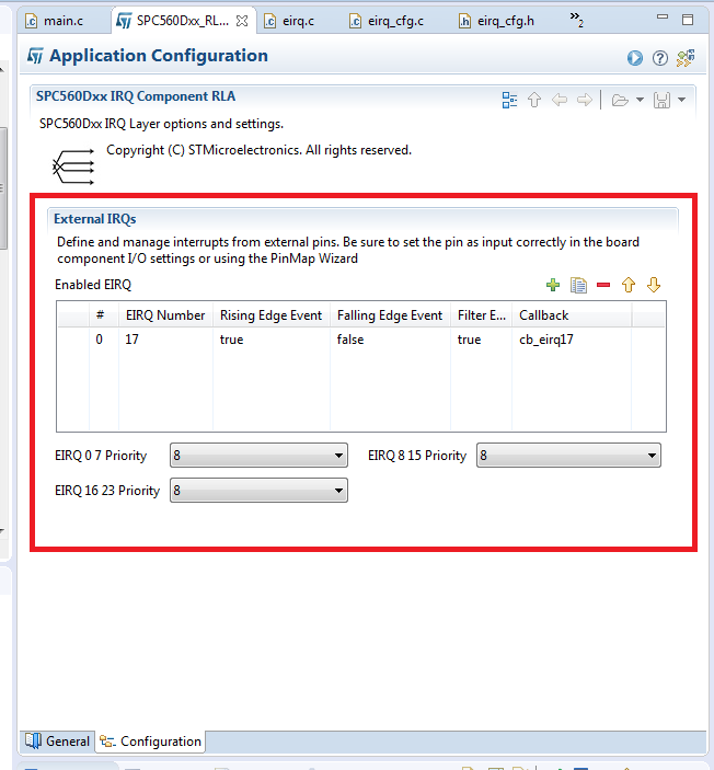

I want to configure GPIO as interrupt(EIRQ),Can you please guide me how to configure using
SPCStudio5(Version : 5.2.1).
As of now i have tried editing the test application and modified ,it is working for me but i am not able to generate
code for EIRQ configuration using
Thanks in advance...

2017-02-07 6:55 AM
Hello Mujeeb
If you want to begin to play with EIRQ (RLA)
1) Enable EIRQ the associated GPIO by Pinmap Wizard (Save the Pinmap, Close the Pinmap and Save the Pinmap)
2) Use the IRQ component RLA
You can import some tests applications from the application wizard.
Best regards
Erwan

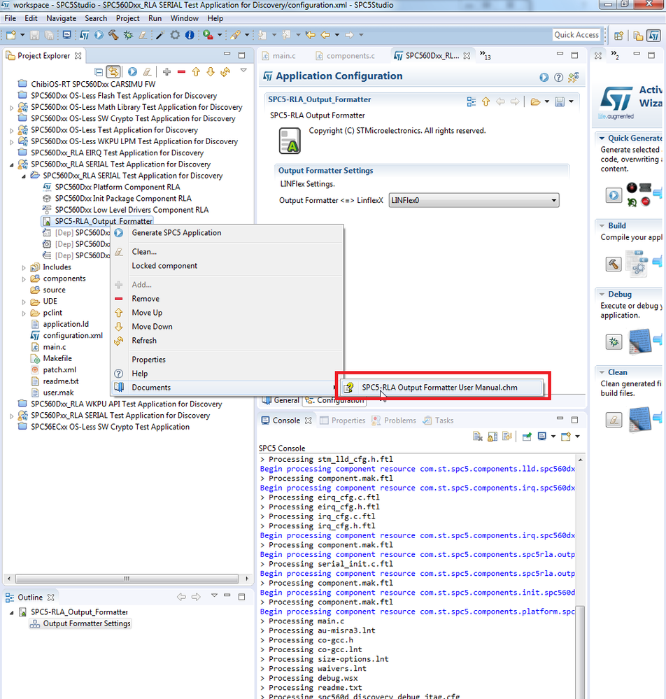

I am trying to use output formatter module in SCP studio,for output the debug messages to console,do you have any example application which is using output formatter.
It will be very help full if you provide any example.

2017-02-10 1:48 AM
Hello Mujeeb ,
Do not hesitate to create a new post for a new question
After adding the ouput formatter in the component
there is an useful chm document.
you have to plug your Output formatter to the corresponding Linflex
Best Regards
