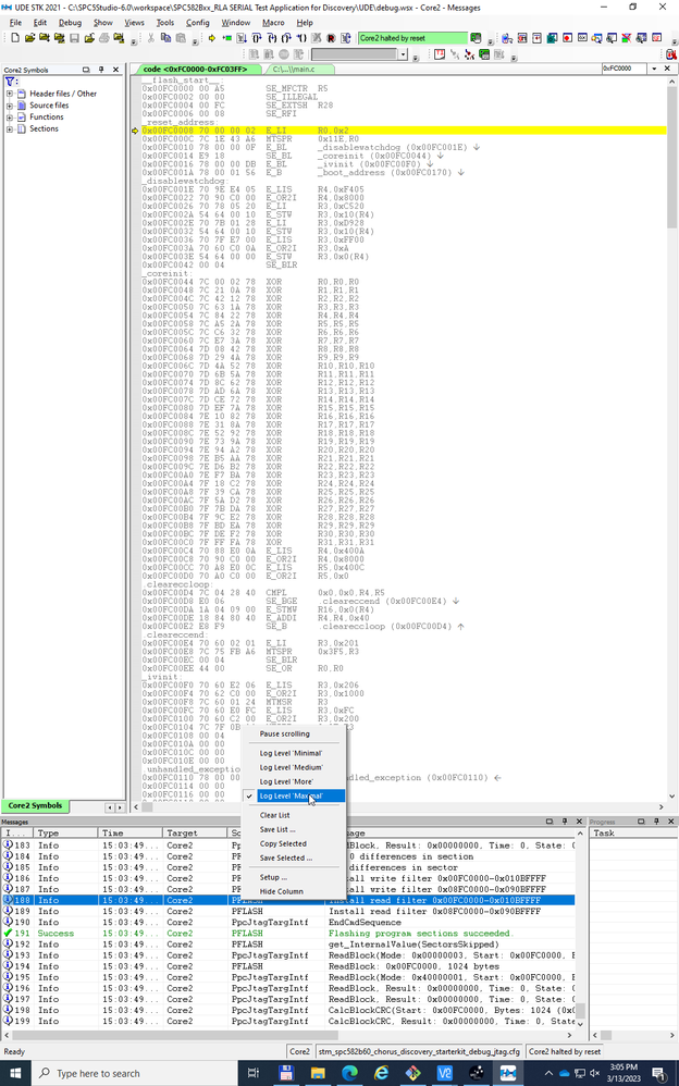

we need to know that how to increase the log value in the "PLS UDE " we are currently using the SPC56P board and spc5studio along with that we are using UDE STK 5.2 for the flashing.

You can increase the log level (cf screenshot) in Messages Section.
(Second Button)

2023-03-13 7:18 AM
(Second Button)
