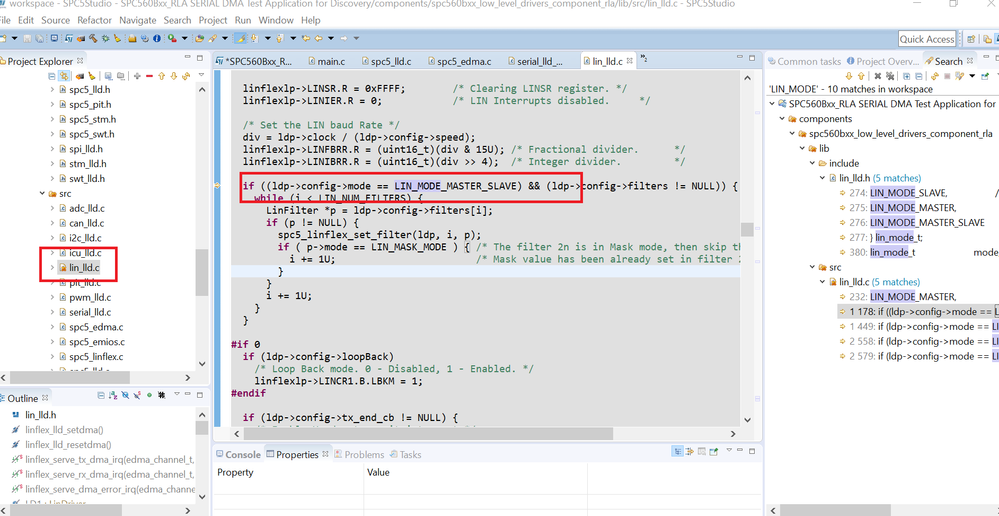

I have a using eval board : SPC58EC-DISP.
I try to receive all packet (slave mode) just like DAQ.
SPC STUDIO support LinFlexD example only using filter.
I think that lin_lld.c - spc5xx_lin_rxi_interrupt (SPC STUDIO Example) is need to modified.
Please tell me if you know that receive way to data without filter in slave mode.

Hello ,
You can update this codeif you want by using the patch mode feature of SPC5Studio
the generation will keep your manual patch
Best regards
Erwan
