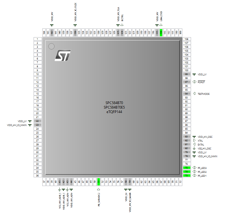

I'm having troble reading the values of te 2 SARADC drivers simultaniously. I wanted to read the values of ADC_1 and ADC_2. I have the SPC584B-DISP
MYoun.7
Associate

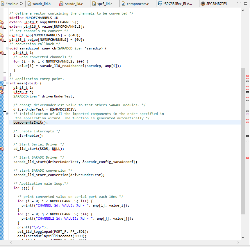

 I tried to change the chanel number but it didn't work, and i also tried to change the driver under test but it gives me an error.
here is my void main0693W00000UoQWcQAN.pnghere is the pin map

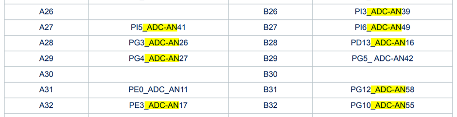

You can find that many ADC channels are mapped to X9 connector:

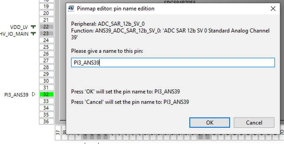

 0693W00000UoS17QAF.pngFor example, with the 2 firsts, PI3_ADC-AN39 and PI5_ADC-AN41, it means channel 39 can be programmed as input pad I[3] of MCU and connected to X9:B26.
And channel 41 can be programmed as input pad I[5] of MCU and connected to X9:A27.

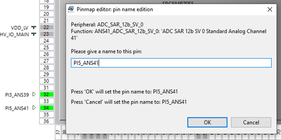

In pin map wizard you can program PI3 to input ADC_SAR_12b_SV_0:
 0693W00000UoS1CQAV.pngyou can also program PI5 to input ADC_SAR_12b_SV_0:

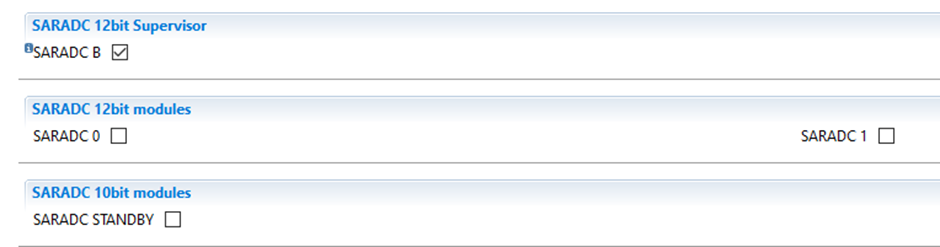

In low level drivers component – saradc settings:
0693W00000UoS20QAF.pngYou can keep the Supervisor driver only

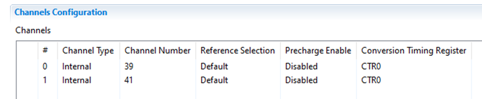

In channels configuration, you must have channels 39 and 41:

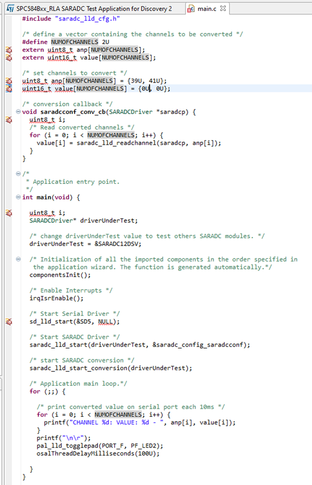

 0693W00000UoS25QAF.pngThen you can modify the demo code “SPC584Bxx_RLA SARADC Test Application for Discovery 2�? with
#define NUMOFCHANNELS 2U
And
uint8_t anp[NUMOFCHANNELS] = {39U, 41U};
uint16_t value[NUMOFCHANNELS] = {0U, 0U};
 0693W00000UoS2PQAV.pngThis way value[0] and value[1] will contains values from ADC channel 39 and 41
