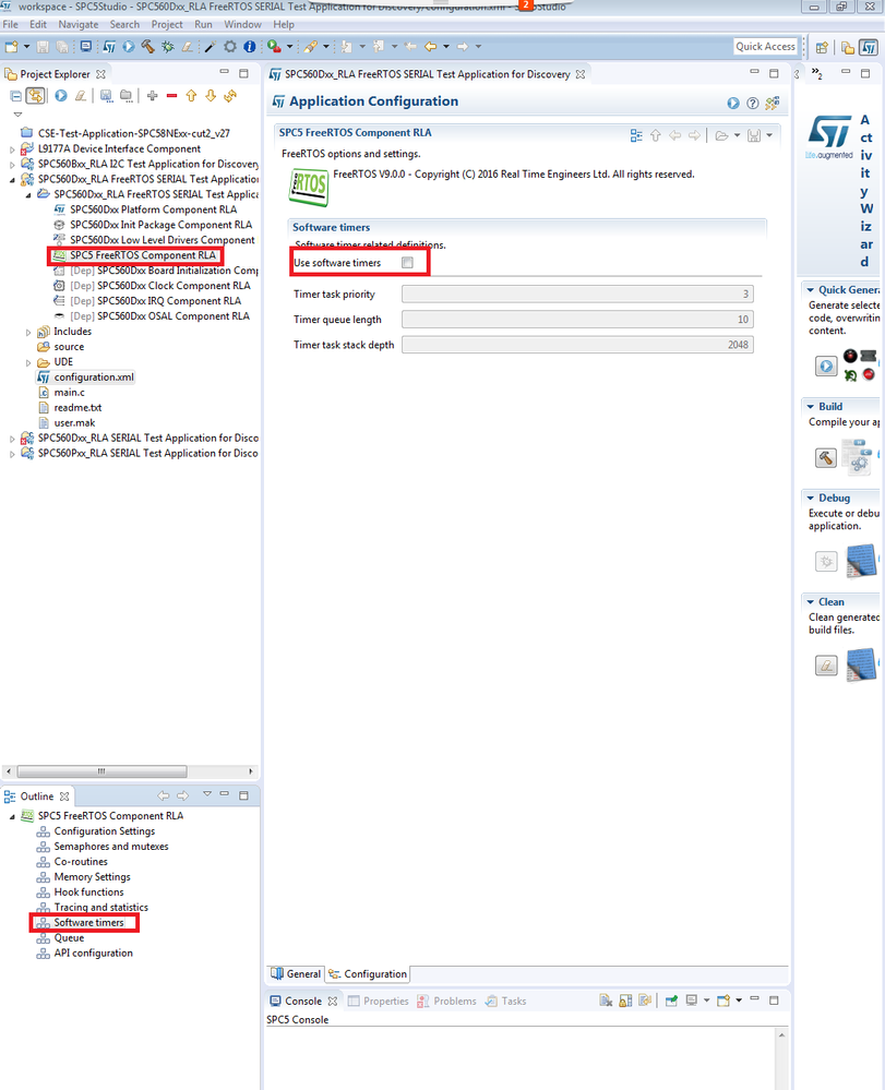

My project uses FreeRTOS, each time the code generated, the macro configUSE_TIMERS will automatically become 0. And the Makefile in the compiler parameters will automatically become -O2. Each modification is very troublesome, how can I do?

Question 2:
the Makefile is generated
1) -O2 is set in the platform component
2) for the timer , Go to SPC5 FreeRTOS Component RLA and check Use Software timers
==> Save and generate

Question 2:

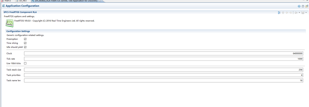

Posted on June 27, 2017 at 02:45
....Why i did not........
SPC5 Studio, version: 5.4
Posted on June 27, 2017 at 09:05
Hello Guo ,
You have not clicked on the good configuration settings.
Click on the outline view to change your panel (cf SPC5Studio Help)
       Best regards
              Erwan

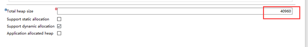

this macro configTOTAL_HEAP_SIZE  This array includes all the necessary queues, task stack memory,
I have a lot of tasks, must be a lot of memory, so I have to configTOTAL_HEAP_SIZE macro set is large, as long as no more than 64K on it. (SPC560B54L5, 64K SRAM)
Posted on June 28, 2017 at 16:06
Hello Guo ,
you can not configure greater than 8192
I recommend to you to customize configTOTAL_HEAP_SIZE
by creating a new constant.
i am creating a CR to increase the limit
       Best regards
