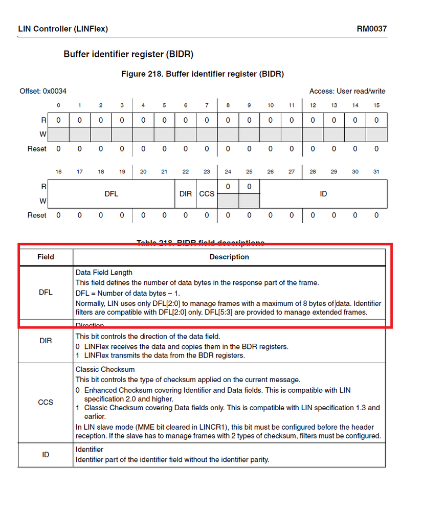

Hello ,

Hi Erwan,
Thanks for your response, but unfortunately, what we are asking is not about Data Field Length which is number of data bytes in the RESPONSE part of the frame.
But we are asking about the delimiter bit length in the SYNC Brake Field of header part of the frame.

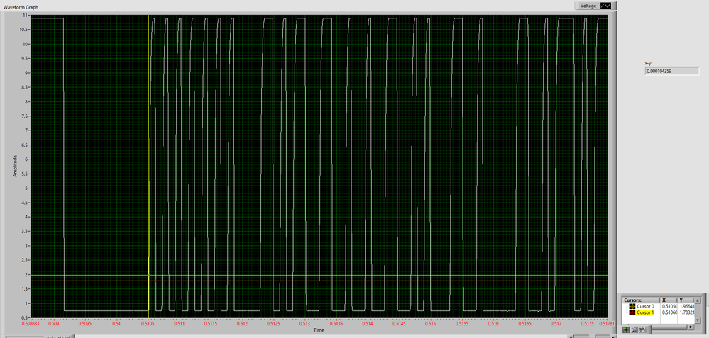

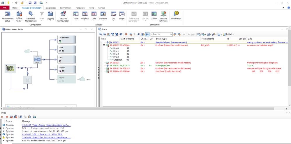

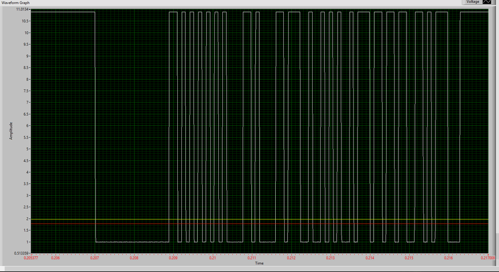

Jkoya
Associate
0690X00000AqUqQQAV.png0690X00000AqUrJQAV.png0690X00000AqUquQAF.pngHi Erwan ,
Thanks for your reply.
SPC_LIN_waveform_9600BPS(first image) screen shot is the LIN wave form generated by SPC microcontroller, which is captured in oscilloscope.
According to this waveform, the delimiter length is not less than one bit, But still i am getting the same error which i mentioned in CANanalyse_LIN(second image) screen shot.
Actual required wave form is mentioned in Simulated_master_node(third image) screen shot.
