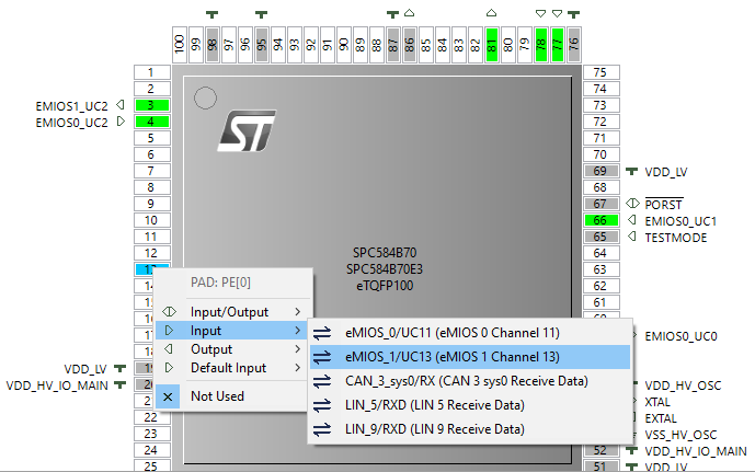

you can open the PinMap editor:0693W00000JMAkdQAH.pngRight click on pad 13 (PE[0]) and selec the source you want (emios0 channel 11 or emios 1 channel 13)
then save you pinmap, close it
save your configuration and rebuild all.

I am sorry if I did not explained my issue more clearly. I know how to set a pin as an eMIOS channel, this is not what I am asking.
If you go to the eMIOS Settings (under Low Level Drivers Component) you can see that only eMIOS0 Ch0-Ch7 are allowed to be configured as ICU. However, in the Reference Manual I can see that more eMIOS channels have the SAIC functionality. I am asking if there is a way to set a different eMOIS Channel as ICU.
