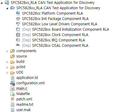

I have two board with SPC582B 64Pin.
i want to test CAN communication each other.
i did import sample what "SPC582BxxRLA CAN Test Application for Discovery"
and i want to use CAN port - 1, 2
i don't know how can i make code.

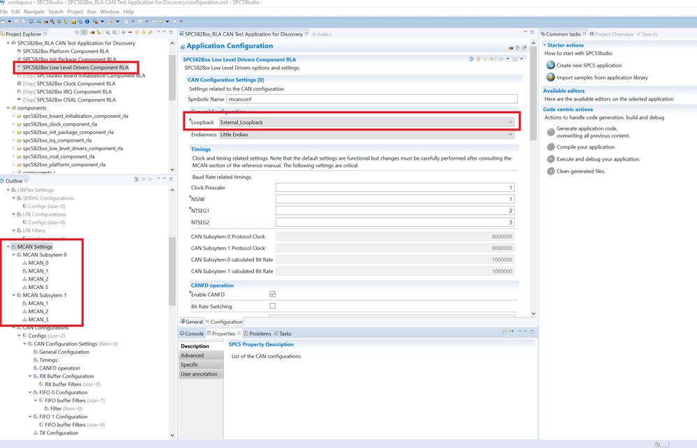

Hello ,
Each Component (Cf Help Section) can be configured
After to configure properly, you have to save and generate your code
Wraning , i think that you have to disable the loopback mode.
Best Regards
