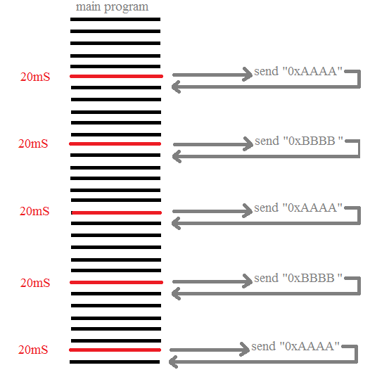

I’m trying to send some SPI command by SPC560 microcontroller. During the main program I must send a special code regularly, for example I must send the code “0xAAAA�? and “0xBBBB�? every 20mS. Actually when the main program is running, if 20mS happened, the main program must stop and send code�?0xAAAA�? and then come back to the last point of the main program.

you can configure the PIT at 50 Hz (20 ms period)
then in you interrupt management, one time you send a 0xAAAA, next time you send 0xBBBB
