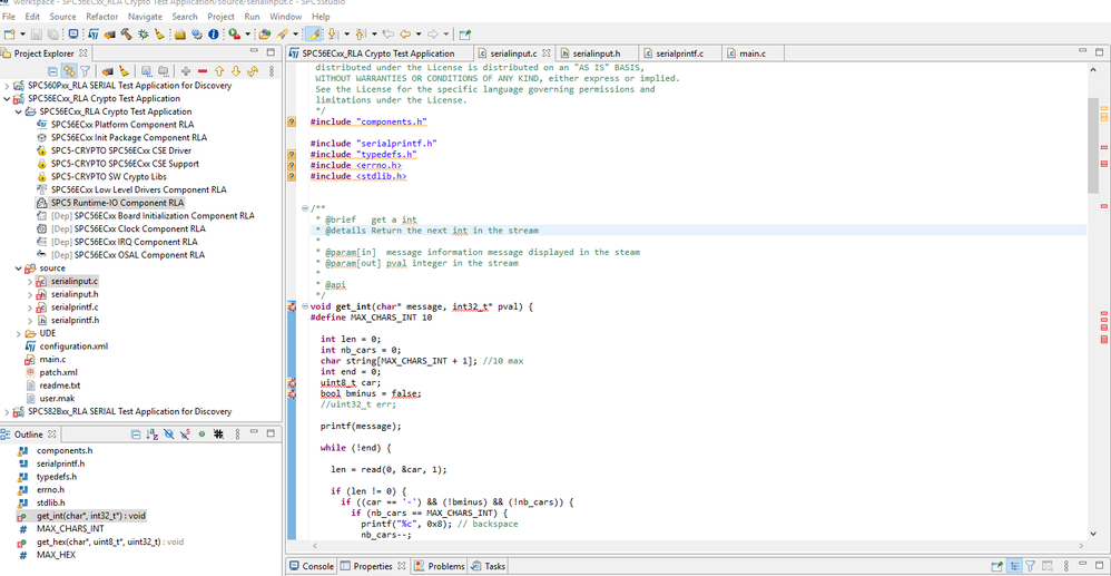

For the big project relative to collect some data coming from UART. (Near-space balloon, Automotive project and so on ..)
we are using :
  • Chibios / FreeRTOS threads to save CPU
  • some functions serial_input.c / .h with Runtime Components (cf Screenshot)
Best Regards
Erwan
we are using :
Best Regards
Erwan
