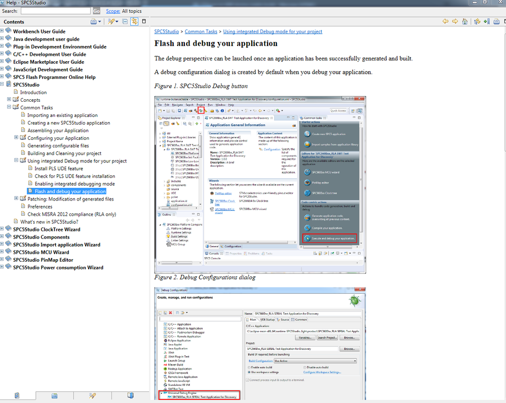

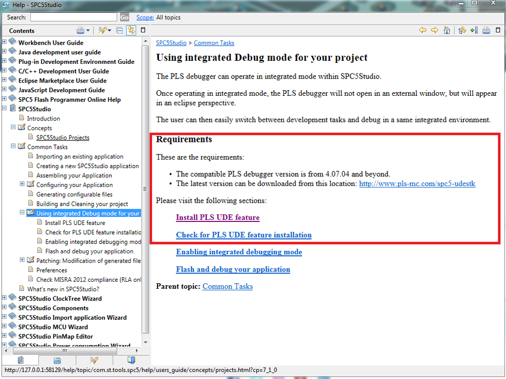

Hello ,
There are an useful Help section in SPC5Studio Tools.
Best regards

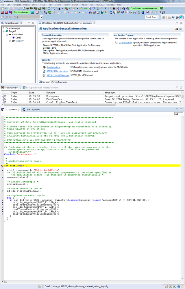

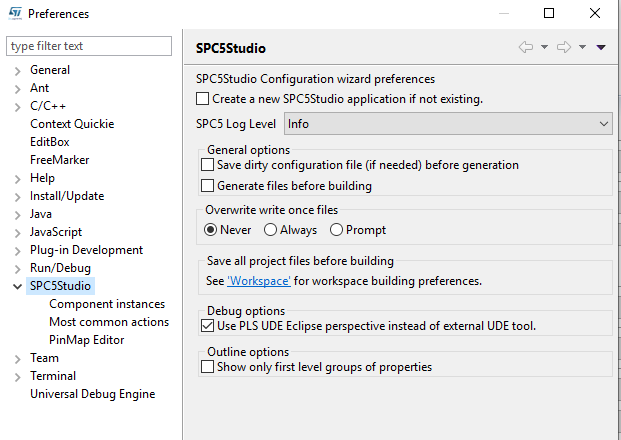

2019-09-17 6:01 AM
in effect I already tried this, but it don't works. The menu below is slightly different from those in the help.
The UDE perspective do not works

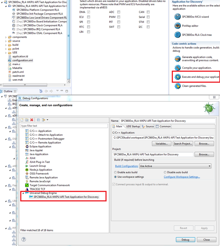

2019-09-17 6:41 AM
Hello ,
The UDE perspective should be launched from the Debug Configuration Dialog not by the perspective
(Cf below)
No problem noticed in my side.
Best Regards
Erwan
