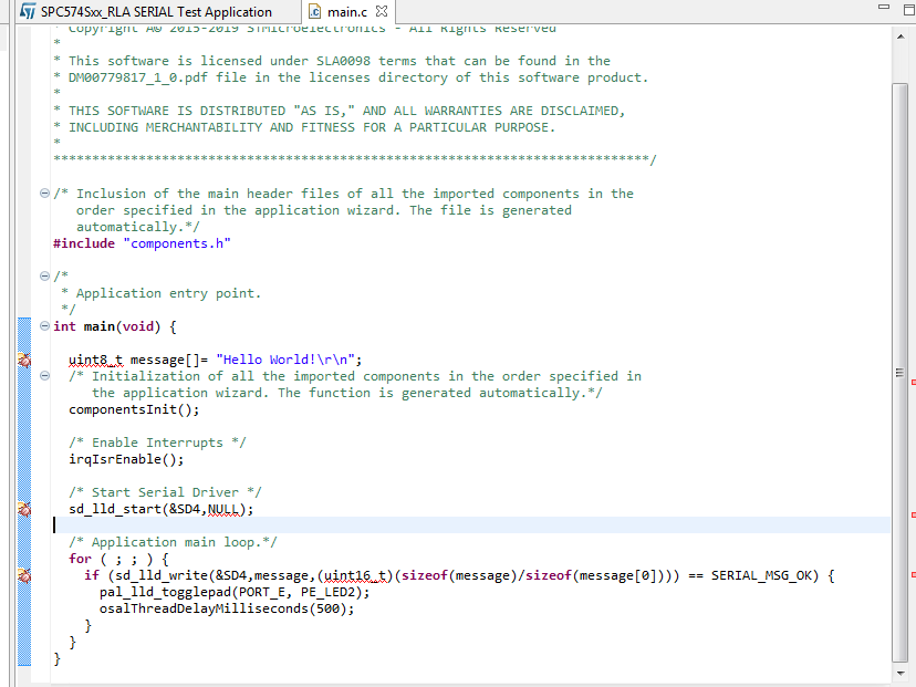

Hello Ain ,
you can use the test application
SPC574Sxx_RLA SERIAL Test Application
The led blick is the main.c

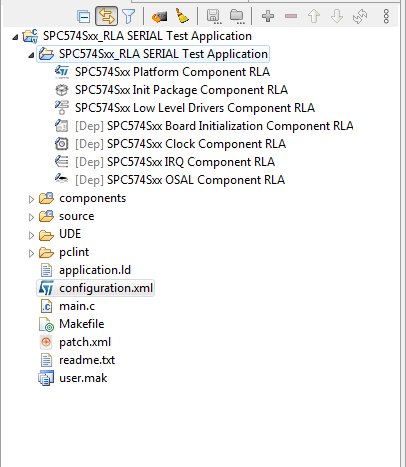

Hello Irwan,
is it this one ? i got confused with the others RLA Test Application
Erwan YVIN
You got it ;)
Led is blinking (toogle function) after sending Hello World on UART.
Best Regards
Erwan
okay, but if i want to use the push button to trigger the LED instead of sending Hello World on UART, so which part of the code can i refer/ modified for the push button? I do not understand how write pin declaration for push button on the c code?
