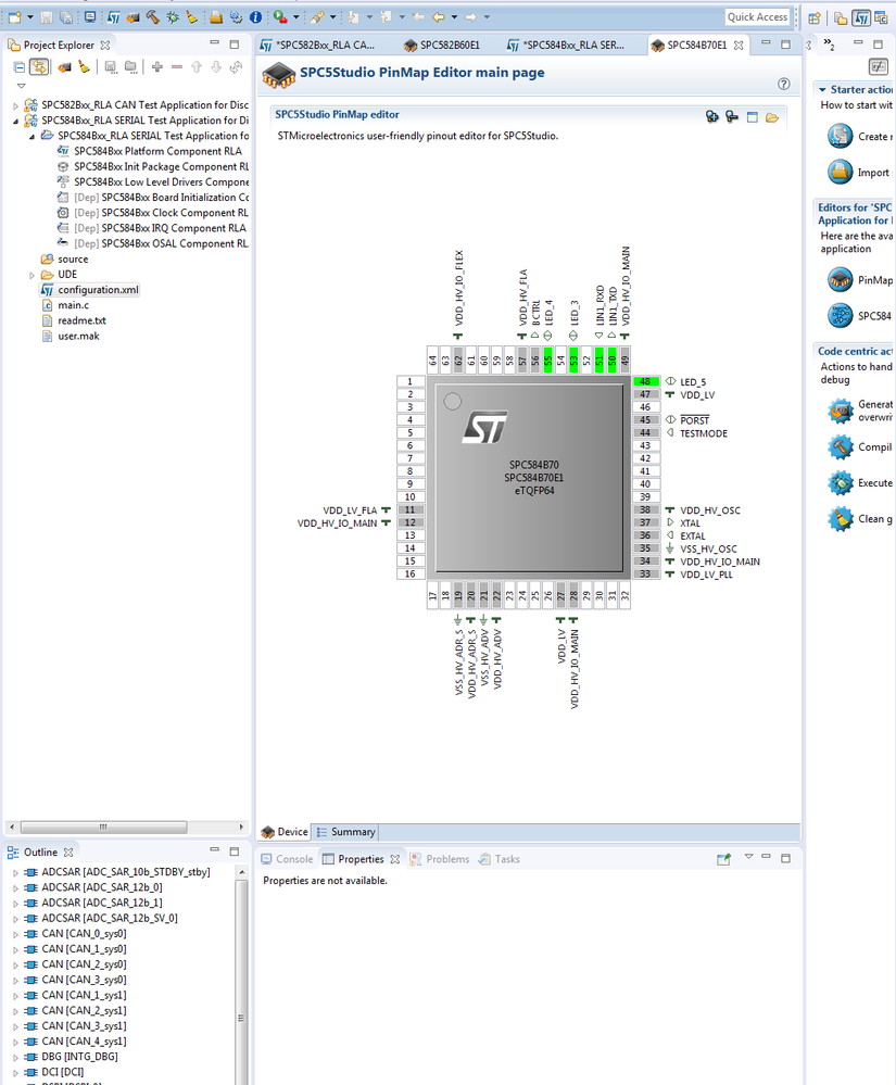

Hello Ayana ,
Board)
Normally , there is a document which describes some Pinout of the board
I am checking that.
MCU )
for the I/O Configuration, you can use the excel file attached in the RM
The smartest way is to use the Pinma Wizard located in SPC5Studio
It will generate your PIN Config by clicking on Save and generate
Best Regards
