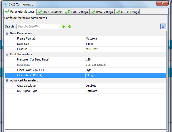

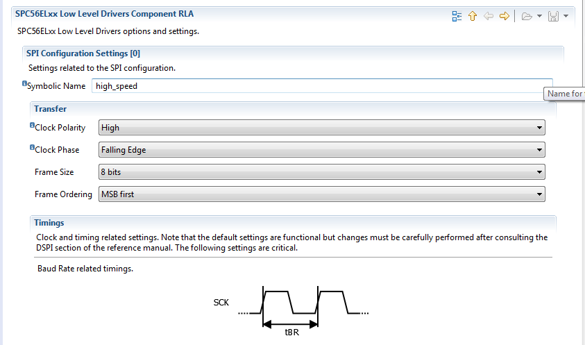

THANK YOU ERWAN ,i have another question..in stm32 cubemx i have configured SPI communication like the pic attached below.polarity high and CPHA=2.i need to configure 2 edge like i did with STM32cube. i didnt see any option for selecting phase ..in phase it is asking leading or falling edge..please help.
