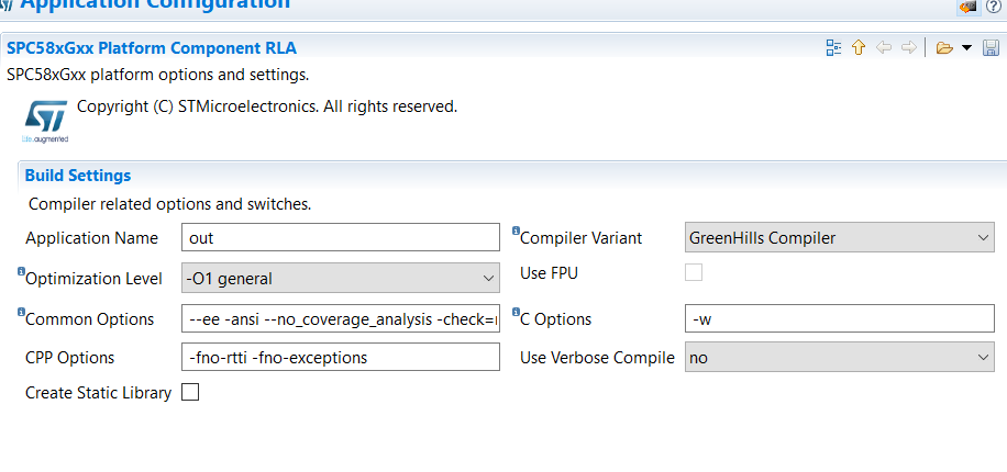

I am attempting to get the GHS compilier to build with SPC58NG dev kit and have switched the Build settings to below
I have updated the project to include the path and commented out the error statement

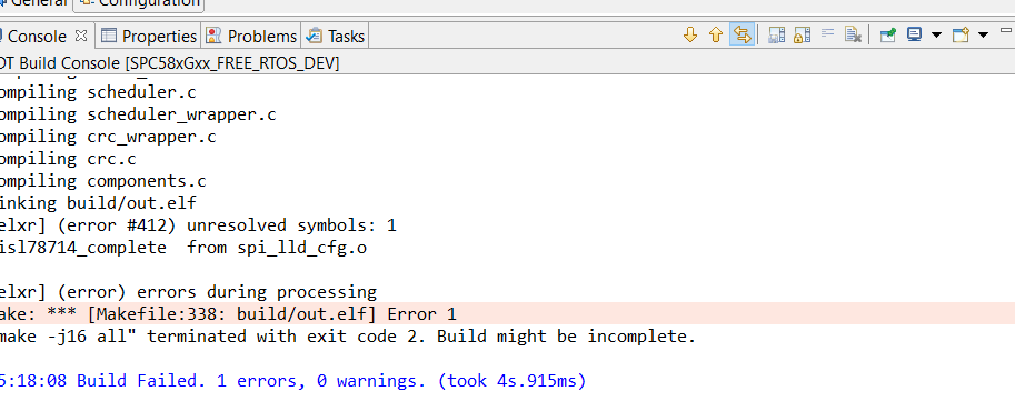

and it will compile but then include some strange error that doesn't really help. Is there any setting I need to fix it looks to be something in the linking process.
Says the linker failed because it can't find a symbol/function to bind with.
Either you're missing a source, or object file, or you have some #ifdef level exclusion of code you actually need, but isn't supplied for the GHS tools.
Perhaps start by figuring out what symbol it is choking on, a partial .MAP or linker output? Increase verbosity level if appropriate.
2021-06-29 8:12 AM
Yeah okay it was missing a callback that didnt bother gcc.
