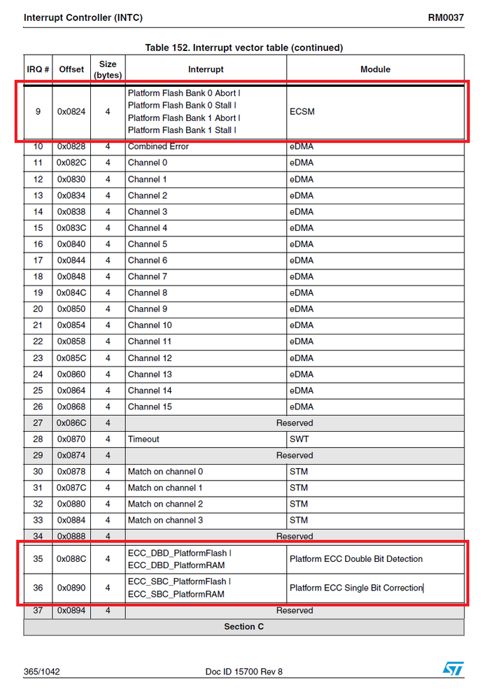

2017-04-25 8:22 AM
Hello ,
we have not some examples applications on ECC.
we have a change request to integrate ECC test example on the application wizard
you can go to the ECSM chapter (chapter 36)
i think that you should use vetcor35,vector36
After configuring your ECSM and enable the interrupts,
you can use
ECC Error Generation Register (EEGR)
The ECC Error Generation Register is a 16-bit control register used to force the generationof single- and double-bit data inversions in the memories with ECC, most notably the SRAM.This capability is provided for two purposes:? It provides a software-controlled mechanism for ?injecting? errors into the memoriesduring data writes to verify the integrity of the ECC logic.? It provides a mechanism to allow testing of the software service routines associatedwith memory error logging.Best regards
Erwan
