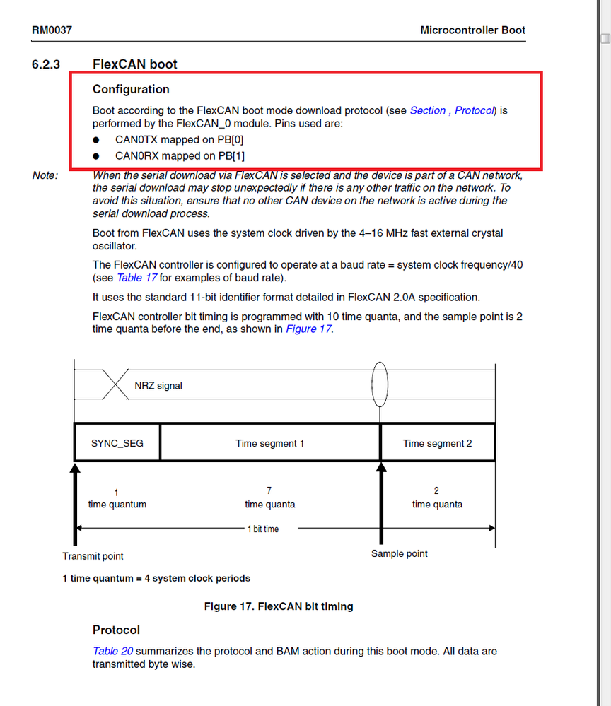

Hello, if i wanted to program the MCU using SPC5 Connect via CAN, what kind of connection did I need to make between SPC5 Connect and the MCU? The MCU I currently using is SPC560B64L7.
2017-12-14 1:35 AM
Hello Wong ,
No , it is FlexCAN0
Best regards
Erwan
2017-12-13 7:39 PM
The current IC that I'm using has CAN transceiver interface and the only FlexCAN available is FlexCAN 4, is SPC-5 Connect tied down to a specific FlexCAN or can it be connected to any FlexCAN that is available?
2017-12-14 1:35 AM
Hello Wong ,
No , it is FlexCAN0
Best regards
Erwan
2017-12-14 4:18 AM
Hello Erwan,
Thanks for the reply. If i want to program my MCU via CAN, the connections are only CANC_RX and CANC_TX from SPC5-CONNECT to CAN0TX and CAN0RX from MCU, is it right?
Regards
Wong
2017-12-14 4:37 AM
Yes , exactly ;)
