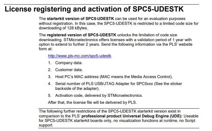

I want to use the automation features of the UDE MemTools with a SPC5-UDESTK programmer, as it is said in this article, but it seams that there is a licence missmatch. Is there a specific license to have in order to use it?

Hello Breish ,
Yes , you can use SPC5-UDESTK programme in CI Automation bench.
https://www.st.com/resource/en/data_brief/spc5-pls.pdf
About license,
the StarterKit version , you are limited to 128k
the registered version unlocks the limitation of code size.

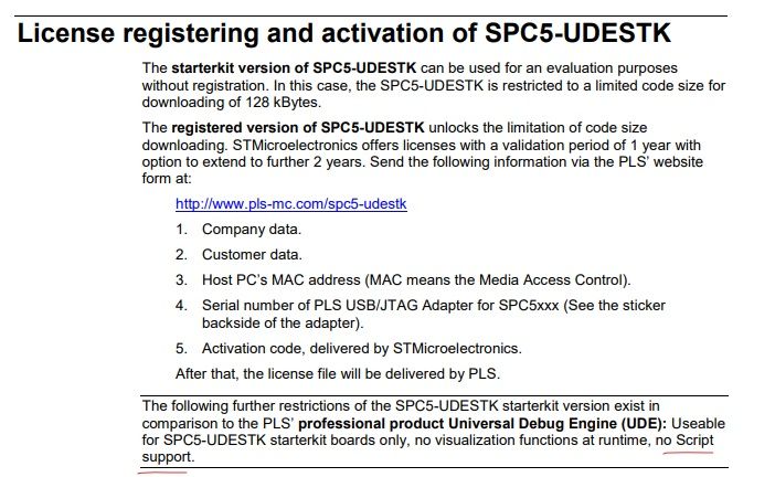

Hello Erwan,
Thank for the answer, but as it is said is the picture, there is no Script support for the SPC5-UDESTK.0693W00000BbNYJQA3.jpg
