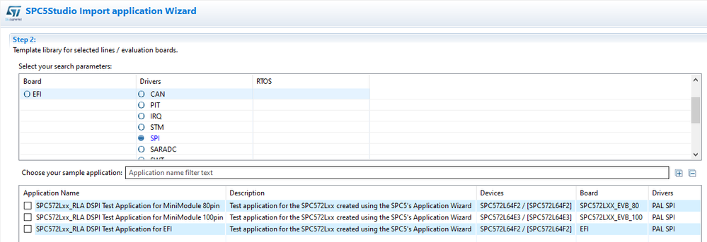

in addition to last good comment, you would find examples to use SPI driver on SPC572L in import wizzard:
