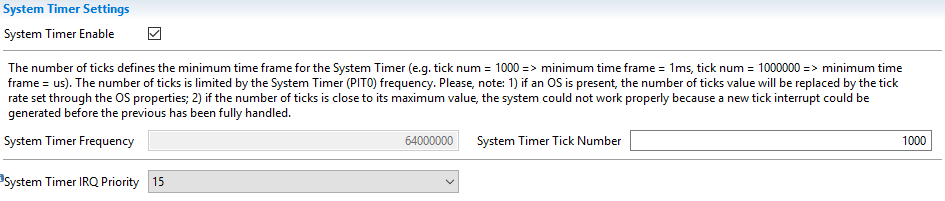

I used 1000 for system timer tick number:

As the recommandation, the number of ticks is limited by the system Timer (PIT0) frequency
Do not hesitate to go to the RM in order to check the PIT Limitation.

Hello Zeke ,
Could you confirm your device used ?

I think the system is running at a millisecond level, and it doesn't work through the osalThreadDelayMicroseconds function.
Do you have any better suggestions? Or can you implement subtle delays in assembly language?
